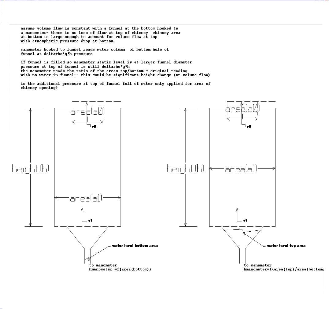

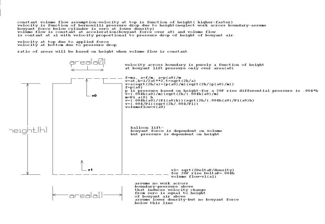

« Reply #2 on: January 28, 2005, 02:08:45 PM »
these pics may help. the first is the assumptions for constant volume flow with bouyant force driving the velocity at the top and pressure drop (assuming no bouyant force) driving velocity at the bottom.  makes more since to put the 'turbine' at the top until you get real tall with the chimney.
the second pic is the part I don't understand- related to how the bouyant force behaves when moving- first part is just air at base of chimney, second part is water hydraulics- my assumption is that the differnce in density of the air is the only thing read in the second one if it is a balloon instead of a chimney- the questions what is it when the air is moving? (same?)
hopefully they are readable.

« Reply #5 on: January 30, 2005, 11:40:27 AM »
the top is force mass equation ,the bottom is bernouilli assuming there is no work done across it-pressure drop drives the velocity --balancing the two so the chimney doesn't leak from the top--constant volume flow for a given (temperature/ height) velocity. Like a trapped balloon. the lift of the balloon (assuming it has no mass) is a function of the volume (for a 3ftdia x 10fttall chimney-about 1.72 ounces).
The part that confuses me about bouyancy is that it only acts over an open area like the hole at the top and the hole at the bottom. if i put the manometer into a ballon 10ft tall full of hot air then i'll read the pressure differnce of the height of reduced density air.
 by hydraulics (not hydrostatics) a fluctuating pressure over a 3ft funnel of water would be this pressure drop (the fluctuation from chimney flow maybe?) over a larger area and moving a larger amount of water in the manometer. (with the upper limit (100%eff.?) at the bouyant lift 1.75oz.mass of water or with the upper limit being the movement of the water at the top of the funnel due to the density pressure drop of 10ft at 20ft (.04lbm/ft3).
from the calcs i did the pressure drop would actually exceed the water volume flow of the 1.72oz balloon lift. bouyancy just doesn't make a lot of sense- like having a bubble pump or something.
whether the height of the water in the funnel would be affected by the balloon lift mass or the pressure based on its height is what I don't get.

« Reply #6 on: January 31, 2005, 08:04:41 AM »
bigger pictures
somewhere around a thirty foot height would be needed for electicity with the turbine at the top-(somewhere around 6ft/sec velocity)
I keep trying to think of this like an upside down waterfall.

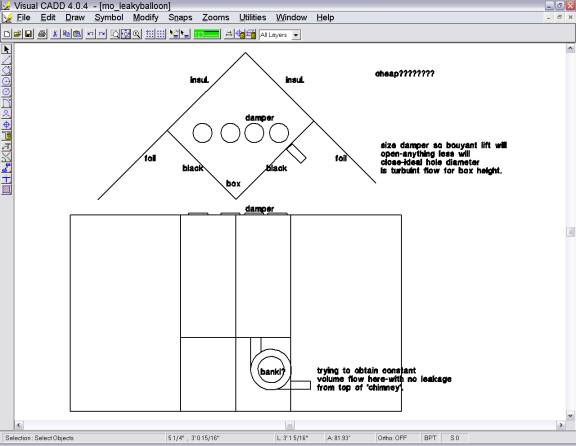

« Reply #8 on: January 16, 2006, 09:26:37 AM »
not enough airflow to make it work. started rethinking the 'leaky balloon theory' and have something I plan to try. I need to find some info on making some cheap, cheap barometric dampers. I am going to put them at the top of a short chimney(refrig. box) and hopefully stop the chimney from 'leaking' at the top even with laminar flow velocity coming out. It should allow me to ratio the diameters and get some pressure drop at the bottom-not sure where the actual stagnation/static pressure drop will be-but at the very least will keep from heating air that doesn't run thru the inlet. ( Manzanarres efficiency was only .01%-will this increase it to .02%?Huh) any ,just an update.
Mike

« Reply #10 on: January 17, 2006, 01:02:03 PM »
the way I invision it working (and this may be wrong thinking) is that the warm air would build up in the box until there is sufficient height of warm air to pop the damper open and exhaust some, at the point the damper would leak air into the box it would close, much like an 'open' stirling cycle exhausting the hot air. the displaced volume would be replaced thru the banki turbine at the bottom and the cycle start over again. I am assuming that the sealing area of the damper would need to at least match the area of its opening and from there be barometrically adjustable. The dampers could be made from the sides of a plastic milk carton with a damper hole diameter of 2" at the box and an overall diameter of 3", balanced at the centerline, with a couple of 45 degree bends so that the top 'flap' of the damper is above the top of the box and the bottom 'flap' of the damper is below the box top. when it tilts open it flows. a small piece of tape could be used to adjust the opening pressure. I invision it as a bunch of small dampers rather than one large one (variable volume flow )at the top.
the 'solar' side of it is that the box would have foil "wings"(dish/trough/etc.) to increase the collection area that impinges on two of the four sides-the other two being insulated.
anybody out there have an opinion/experience/etc. in regards to something like this.
Mike
« Last Edit: January 17, 2006, 01:02:03 PM by Kwazai » Logged

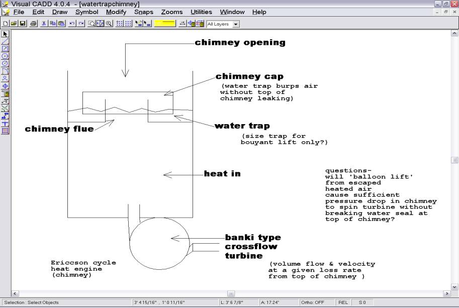

« Reply #11 on: January 18, 2006, 09:05:05 AM »
complete rethink- feedback wanted-see pic
Mike
« Last Edit: January 18, 2006, 09:05:05 AM by Kwazai » Logged
