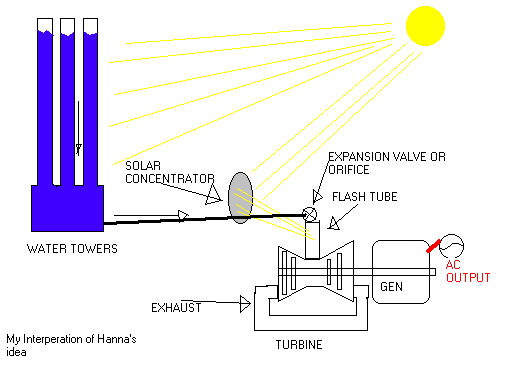

The above is my
very rough picture
of a solar flash steam turbine.
I simply got enough
of drawing with a computer
and wanted to put the main idea first here.
I will make better pictures later.
DESCRIPTION:
Part A.
1. There is water in the container.
In the bottom of the container there is pressure,
because of the gravitation forces.
A water tube starts from the bottom of the container.
2. Sun rays hit the parabolic mirror 3.
The available power from the Sun is about one kW per
one square meter.
3. The parabolic mirror of 2 square meters reflects all
the sun rays hitting the mirror to the chamber 4.
The water from the tube goes inside the chamber.
4. The flash steam chamber is finned inside
with spiral fins so that the water coming in
is effectively suddenly heated.
There is needle valve letting the water in the chamber
from a small hole.
The chamber is made of ceramic at least outside,
so that it can be heated by the parabolic mirror
more than 1000 C hot.
The chamber is expanding inside towards the outlet end.
Inside the chamber flash steam is generated.
5. The flash steam coming out from the chamber hits
a crossflow turbine made of ceramic.
The crossflow turbine runs a generator.
Part B.
The parabolic mirror is arranged to be turning round
on an axle, which is on the same angle
as the axle of the earth.
There is a clockwork to move the mirror
so that it all the time focuses in the chamber.
DISCUSSION:
  1. The main power is coming from the Sun.
  2. Water gravity is used to jet the water inside the flash steam chamber.
  3. No big and complex boilers are needed for this kind of steam turbine.
  4. This solar flash steam turbine is simple to build even in rural workshops,
if ceramic craftsmanship is known in the area and
somebody teaches the right shape
of the mirror (parabolic),
which can be made of cement using small mirror
pieces as reflectors.
Reflectors can be made quite easily by pressing
machinery from steel as well:
5) The electric energy available
out of the process?
a) As told above, there is about
one kW heat energy available for
one square meter from the sun.
It is quite safe to assume that we can arrange
more than
50% of the sun rays' heat energy
to be absorbed as heat energy in the chamber body.
b) All that heat can be transferred into the flash steam
heat and kinetic energy, because the energy cannot escape other way?
c) A simple crossflow turbine generator can be made
maybe 20% effective.
So if our mirror is
2 square meters,
we might expect
200 watts from the turbine?

I like this idea because it incorporates the tall water towers. These water towers will receive sunlight from all angles of the sun's travel. Hence the only need for tracking is for the flash tube. And I believe these towers can accumulate allot of energy. Its definitely something to work with. If these towers are of significant height the solar reception qualities will improve. Also the pressure on the water should be significant. However at the top of the column you will most likely have some issues. Due to convection circulation. but it would be interesting to learn from such a device if it worked or not. I'm not quite sure how to deal with the exhaust from the turbine. Or how to get the water back in the towers. often solutions present themselves with diligence and discovered options. JW-

Looks promising.
I like the idea of using the water towers as solar collectors to build up some small pressure before the flash tube. The valve is a great idea, as it simply lets some low pressure water squirt in, and when the water flashes, it seals shut. Its a great idea. Looks promising. Might try and build a small solar flash boiler for fun.
Although I would reccomend some heat sinks installed before the valve to simply draw a slight vacuum at the valve. (as pointed out in my idea above.)
Also, I have seen solar boilers before that incorporate a darkend tube running through a focal point of an elongated parabla. (I think the Mojave desert solar thermal power plants runs this way)
-Andrew
Re: Flash steam (4.00 / 1) (#19)
by troy on Sat Jun 28th, 2003 at 08:50:07 AM MST
The big advantage of parabolic trough collectors is that they only have to be tracked in one axis, in comparison to a parabolic dish collector which must be tracked in both altitude and azimuth.  Plus the boiler/heater tube in a trough collector sees less photons and heat per square centimeter, reducing the need for exotic high temp materials that still have good heat transfer qualities.  Furthermore, a very good approximation of a parabolic trough can be made using plywood ribs and aluminum foil or mylar, so the cost becomes very inexpensive.  For something more durable, the trough may be made of many 1.5" wide strips of glass mirror mounted on parabolic ribs.

I think if you can keep that parabloic mirror on the focus point (ball flash chamber) at 1000 degrees or close, you might not need a valve at all. The flash explosion would both spin the turbine AND back the water up for a brief moment. Who knows? anyone?

I changed the original
hand drawn picture for a computer made
rough picture.
The original 'hand made picture' is still
among my picture uploads.
How to draw this simple picture easily with
my computer I learnt from JCP.
