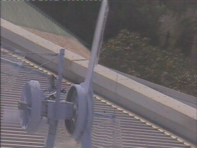

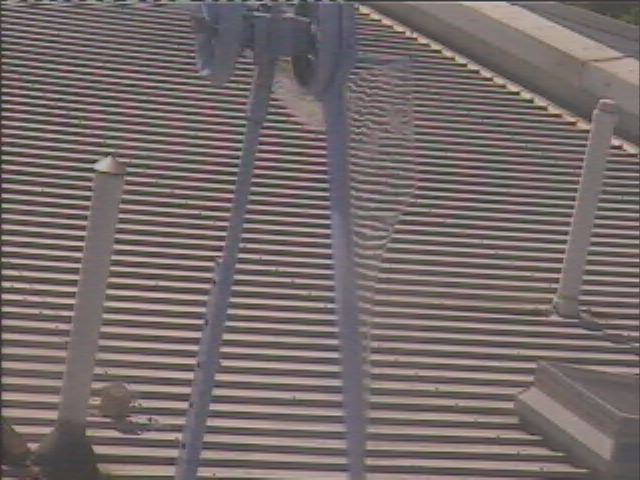

Re: wind flex on bigger props help (3.00 / 0) (#6)
by adelaide on Sat Oct 29, 2005 at 06:58:26 PM MST
thank u for some advice still bit unshore about lamanated wood thow ? i have very strong hub aria glued to ply circle with wedj inbetween each then screws from ply to blade then washer on screws from f/p hub all way threw blades and ply (f/p hub cos easy off on/and some times have 2 f/p alts on each front and back).this 1 wired 100 series delta good for only 200w 12v (ushaly 2 alts on this 1)but makes power from 100rpm and furls early ,is my lo wind power experament works 2 x better than outhers in lo wind ,outhers give me over 111amps (around 1500w)in hi wind all close to factory roof cos im close to city. will send pic (roof cam)it most have plastic inner bits bent after ovened. pole is 2inch and bottom is heavy lath rail which i still cant belive flexes when the resont wobble sets in ,gyde wire from center pol in middle prop help but not good enuf ,could it be cos say top gets more air flow /1 blade has more lift??.sort of looks like 3/4 way may flex or all prop blades follow woble ?,outher four next to it are perfect but 2.2 meters diameter av. sorry about spelling, wood is pine i think .can it be tail needs to be reenfoced so it cant flex as well? will prob try dif balancing random weight then move to see if helps and next one thicker,any enginear idears like gyro powed by it ?hahah<(like the power of big prop when outhers are still in lo wind)

Re: wind flex on bigger props help (3.00 / 0) (#11)
by Experimental on Sun Oct 30, 2005 at 01:04:37 AM MST
   Hi Again Adelaide,
    Looks like you are getting a lot of turbulance, from many structures on the building -- that will cause lots of problems !!
    Other than that, I was once looking at the F&P conversions myself, and as I recall -- the shaft was very small in diameter, and the hub, made of plastic !!
   You could very possiably be getting a lot of "flex", in both the shaft, and hub-- along with long blades --- that would set up a lot of FLEX problems
   The lamanated blades, will definitely, take a lot of flex out ,but you still may have a problem with the shaft and hub !!
   The other fellow, that wrote you, sounds like he is near you, so perhaps he can help you -- I,m in the USA, so I can,t drop by, and take a look ( would love to though)
    I wish you good luck with your project -- and maybe it,s time to go to a dual rotor !!???   Bill H.........
