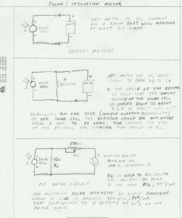

Johnlm, would it be possible for you to post a simple drawing for your gadget?
Re: Smog and panel output (3.00 / 0) (#8)
by johnlm on Tue Dec 20th, 2005 at 04:43:31 PM MST
Give me a day or 2 and I will do that.
John
Re: Smog and panel output (3.00 / 0) (#9)
by johnlm on Wed Dec 21st, 2005 at 11:17:00 AM MST
Here is the info on my Solar Insolation Meter.
First a few explainations.  The easiest way to get relative measurements is to just connect a solar cell to a meter set to measure current in the range that the output of the solar cellis capable of.  ie a small cell that puts out 0.55V at 0.5 amp would have you set the meter on say a 2000mA scale.  Note the reading in full clear day sunlight and compare that to one of your smoggy days with the cell oriented the same way at about the same time of day to determine a relative measurement of the two readings. This approach is shown in the first schematic on one of the pics below.
The second schematic on the page shows how to make relative measurements using the meter in voltage measure mode.  Note that the value of the resistor across the solar cell needs to be low enough in value to get the solar cell in a current source condition.  That means the resistor is loading the cell so much that the output voltage has dropped from its normal 0.55V down to around 0.1 to 0.2 Volts and any change in light intensity shows up as a linear change in output current which is read as a linear change in voltage across the resistor.  If you don't have the cell loaded enough the output will not be linear, but dont load it so much that it totally kills the output.  For my small 10 X 20 MM cell I used on my meter which can probably only put out maybe 50 mA max the value of the load resistor was 15 Ohms.  I experimented with a larger 20 X 40 MM cell that is rated at 0.55V and 0.3A this morning I found it needed about 2 ohms of load resistor.  I bought the cell at Radio Shack about 15 years ago.

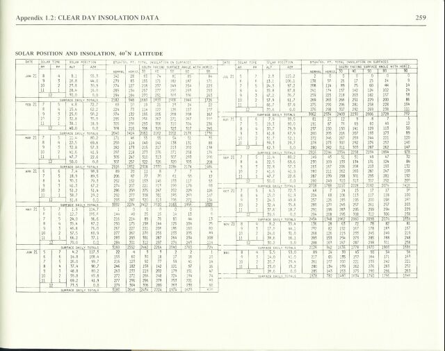

To make a meter that reads actual values of solar insolation is a bit more complicated as you will need to use solar insolation tables to get an idea of what kind of intensity (usually in the USA measured in BTU/Ft^2/Hr) you can expect.  Now if you live in an area that always has some smog or hazy skys then these tables will not be correct as you will always measure less than what should be available.
I have put in a picture (below) of one example of these tables that works for me as where I live in Colorado totally clear skys (other than when its cloudy) with no haze or smog are the norm.  There are other tables that give approximate values of BTU/Ft^2/Hr or Watts /Meter^2 on map contours for the USA.  Possibly these are available for all over the world if you find the right sites on the internet.
If you use the approach in the second schematic you could make up a table of output voltage readings for various availability listings on the table to have a somewhat calibrated measurement.  I have found that calibrating these is best done with the cell in the horizontal position as you get less reflected light onto the cell.
Schematic three shows the actual circuit in my meter using an old analog meter movement I had laying around.  The meter is set up to read voltage and the corresponding variable resistor in series with the meter is of a value that works with my particular analog meter movement.  The potentiometer was adjusted to calibrate the output reading on the meter scale with the known incoming sunlight intensity.
