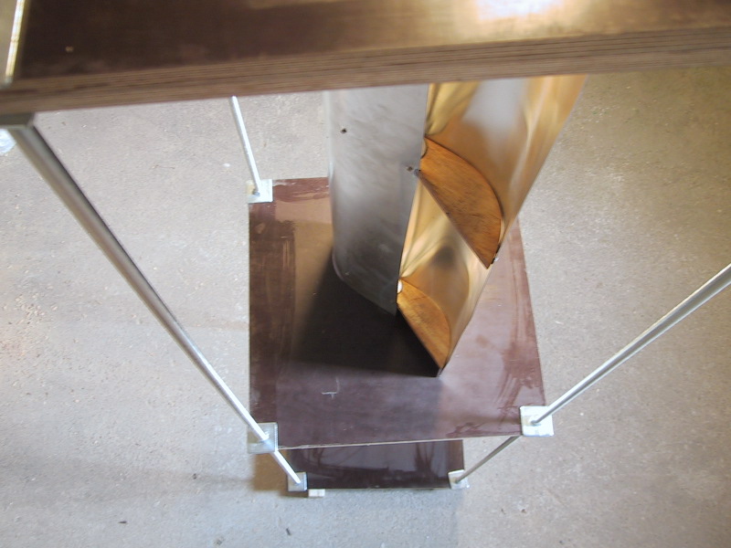

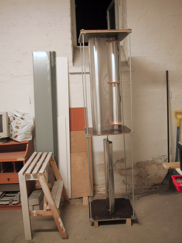

I just put my Savonius first time together yesterday. This one is goind to high tree at my cottage. The small genny is going to be on top of the lower half and stator is held by another plywood layer. It starts easily in low wind but I'm conserned about the spinning speed. In a week's time I'll know much more.

Looks good Hanski, I'm wondering how the material will hold up over time and weather. What size alternator are you using and what is the cut in speed? Rob

Aluminium blades should be OK. Other metal is mostly stainless. I'm little bit worried about the plywood and I'm going to handle the edges somehow. The wooden profiles inside blade got oil treatment. We call it woodoil which is made for outdoor furniture. They might hold two years?
Alternator is small 7,6 inches with 12 (24) 0,8inch neos. If I get 100W I'm happy, 50W is OK. Cut in speed is 100rpm.
It looks a bit crude but this is my first project ever so please forgive me.
//Hanski

Looks fine. you don't want to invest a lot of time making a super good looking project when you get started . All my beginning projects were major failures as I'm sure most other builders projects were. Lots of people build big projects for there first mills and unless the project is through someone who has done it before they rarely amount to much.
