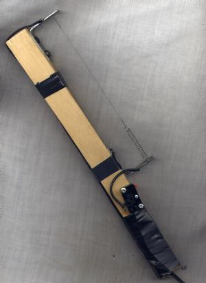

Maybe you mean something like this:
http://www.fieldlines.com/story/2006/4/7/13354/21751
(sorry I don't know how to put a link)
As you see my mold is wood.Quite much work.
Maybe clay is faster,but for a reasonable size it
will be difficult.Clay retracts when it dries.Cracking
and breaking and so.
I've been thinking of ciment.
First build the rough shape from stone or brick.Then finish
with cement and/or plaster.
But what the heck did you make your styroffoamcutter for.
don't underestimate the work of fiberglassing without bubbles.
Not very cheap neither.
Not yet a good method for mass production.

by windstuffnow (elenz(at)windstuffnow(dot)com) on Tue Jul 11th, 2006 at 05:37:31 PM MST
  Those cutters are fun!   I built one a few years back and put it on rollers.  I could copy just about any airfoil shape with it.  I used guitar string for mine.  The trick is getting it and keeping it at the right temp.   Then holding a steady hand... it picks up vibration or a nervous twitch quickly.   You could make up 1 blade to copy and cast it in a 2 part rubber mold.   Doesn't stick to plastics and what you mold is what you get.  Its fun to work with.  I've been using the "oomoo" its a 1 to 1 mix and hardens in 6 hours.   You can make hundreds of parts per mold.  smoothon.com has the stuff.
Have Fun! Windstuff Ed
