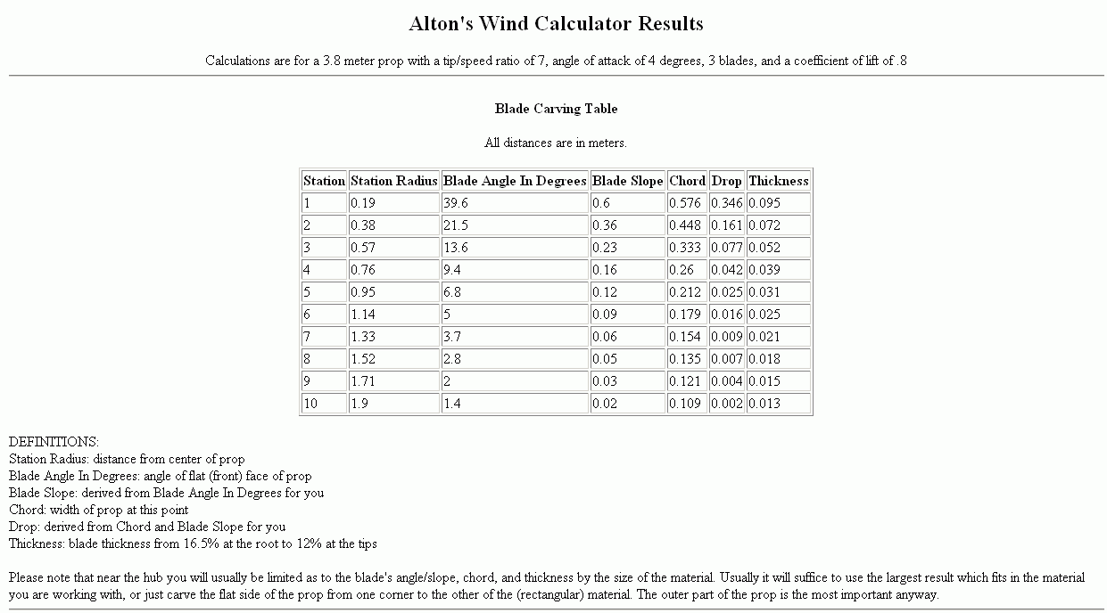

Re: help with chord width/pitch (3.00 / 0) (#3)
by clflyguy (sidney.raiford@gmail.com) on Tue Oct 9th, 2007 at 02:05:36 PM MST
Carl,
Here are the numbers for a set of blades that correspond to the 1.67m blade length
you mentioned. I assumed an 18" dia. hub- hope this helps.  Gus
