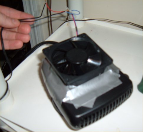

Thought I could mention one more thing about controlling this small windmill in very high winds before this post goes away. We have had several VERY windy days so far this spring. (40-50mph+) What I do now is, I hook one of those little 12vdc car heaters (200watts) directly (NOT thru the batts) to this windmill in these high winds and it controls it very well-- after the batteries are full.  You have to run a separate wire to the little fan in it though, or the voltage drop (down to around 6-7 volts) at the heater will blow out the transistor in the brushless fan. (which I unfortunetly did) I had to temporarily rig another little 12vdc fan (2watt) on the top.
Later, I will make a better set-up with more heating elements. I'm going to do many 'on-off' switching type experiments, to try and get more heat. Its pretty cool - I actually get some decent little heat coming out of that little $15 200watt heater in high winds.  I just got my xantrex C-60 controller - so this little heater will be the dump load for it  now. I can't wait to hook it up, since its been a pain in the neck always watching the battery volts and turning on my TV in the middle of a windy night! When the 12vdc heater is hooked to the generator directly the blades turn only about 120rpm in about a 20mph wind. (under 20mph they stop) They turn only about 300rpm in a 30mph wind. But at about 35mph-40 they really take off and spin up fast to about 800-1000rpm (guessing) and then heat comes out of the heater until the high gust goes back down below 30mph. But it is still noticably controlled. It don't spin too much out of control like before. Thought I would just mention these recent facts. I can finally sleep at night.
