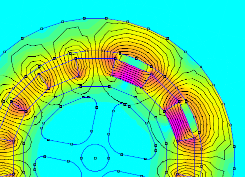

I have spent some time looking at this type of alternator using FEMM and have concluded that segmenting the shaft and replacing the centre and rear of the shaft with a 316 stainless tube rather than the solid steel one, will allow a steel rod to be inserted much like a reactor control rod to limit the output of the alternator.
The centre (Fe) shaft is acting like a return path for the fux no doubt about that.
By removing the Fe Shaft in the section inside the magnet rings, you prevent this "short circuit".
So conversley if you insert a rod inside this SS tube then the output of the alternator drops around 3 times.
As a cheapy, I thought that a back to back Hallbach assemblies, replacing the outer two of the ring magnets could be made from inexpensive NdFeB slithers (.5x.5x1).
The inner ring can be replaced with Aluminium disk with a simple steel washer between the Al disk and each of the Hallbach replacement assemblies would give the same output as three solid rings of NdFeB. Hallbachs are One Pole magnets. Basically you take 4 magnets and do this "North Up,North Right ,North Down,North Left" you can put the field on the inner or outer of a drum by changing the rotation of the magnets Clock wise (inner) or Counter Clock wise (outer).
Fun to play with ! Same thing as fridge magnets only one side is magnetic.
The Hallbach is Root 2 (x 1.4142) factor stronger than the equivalent solid magnet.
Three magnets stacked are 1.27 x the single magnet strength stacked.
So by taking smaller magnets of the same strength you can actually end up with 1.8 x the field over 1.27 of the 3 solid magnets.
Crikey ! It's a significant figure !
The picture shows the intense hallbach on upper right versus the normal In Out
of a normal radial flux unit. Purple is hight Field Strength.
Anyway I have to take some videos back.
Garret
All in good time but for now .. a mirracle
Re: Easy Auto Alternator Conversion (3.00 / 0) (#26)
by SoloDad (Garret_at_ Kisser_Net_Au) on Thu Jul 5th, 2007 at 08:23:57 PM MST
(User Info) http://www.outaoz.com.au
Hmm I spent the time to model this Halbach Augmented Idea.
Well .. forget I mentioned it. Please !
It does not work.
Sorry. (in too much of a hurry to exit to the video shop)
Remember that all great ideas stimulate the grey matter ..
no matter if they work ! Keep on using it !
If you replace the rotor entirely with a CCW 90 deg rotation of the field magnets
about the outer surface of the drum with a thin layer of steel under them .. (see www.Windstuff.com) but rotate the magnets. You will pick up the Root 2 advantage ( note the magnetic flux is different as the wire goes through the field.
The normal up/down magnets give a rough sine wave +- 45 say. The Halbach goes zero across each second magnet. It shows +75 then zero for a magnet width then -75 then zero for a magnet width. Kind of a square wave with a zero 1/4 wave each 1/2 cycle.
Anyway .. it will give much lower start to charge rotation speed.(values are only indicative of the model I made with 94m OD Al Drum , 3 mm steel plate wrapped with 16 off 15x40x8 mm NdFeB Magnets around the outside. and are x10e4 Amp/Metre. but ... cogging .. wow it will be nasty.
So When I find a 3D FEMM modeling software I'll have another go with a compounded Halbach type stepped so that the cogging will drop.
Garret
