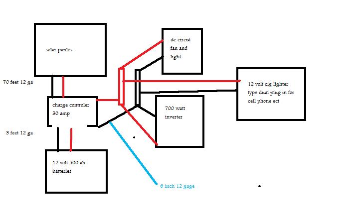

Second try to post system layout.
Sorry not a very good drawing.

by ghurd on Sun Jan 13th, 2008 at 11:01:10 AM MST
Yea, the losses from the battery to the inverter are too much.
Not just the wire loss in the shown #12, but from the bus bar to the inverter and the controller has semiconductor losses in between.
That doesn't explain why the controller would show 13.8V while the battery was at 12.6V.  Might double check the connections with a volt meter.

by scottsAI (user name at eml dot cc) on Tue Jan 15th, 2008 at 10:22:29 AM MST
Birdmmjb,
I have my doubts about the controller. Not rated for full load of inverter.
Connect the inverter directly to the battery.
Most inverters will shutdown on low voltage, making the controller redundant.
Keep the other loads connected to the controller.
Your wire is thinner than I would use, but its what you have. Lengths are short, making the above changes should allow it to work.
Have fun,
Scott.
