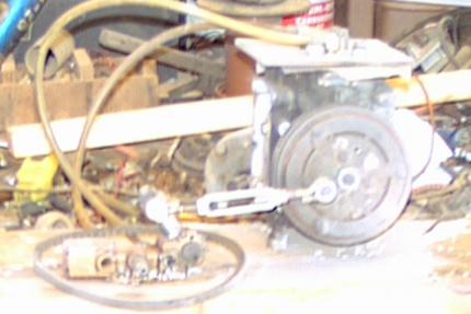

Try this it works and runs at 500rpms at 100 psi air.
Yes that is a screen door adjuster. It helps set the timing. 4 way air valve with manual handle. Thats paper for a seal for now.
