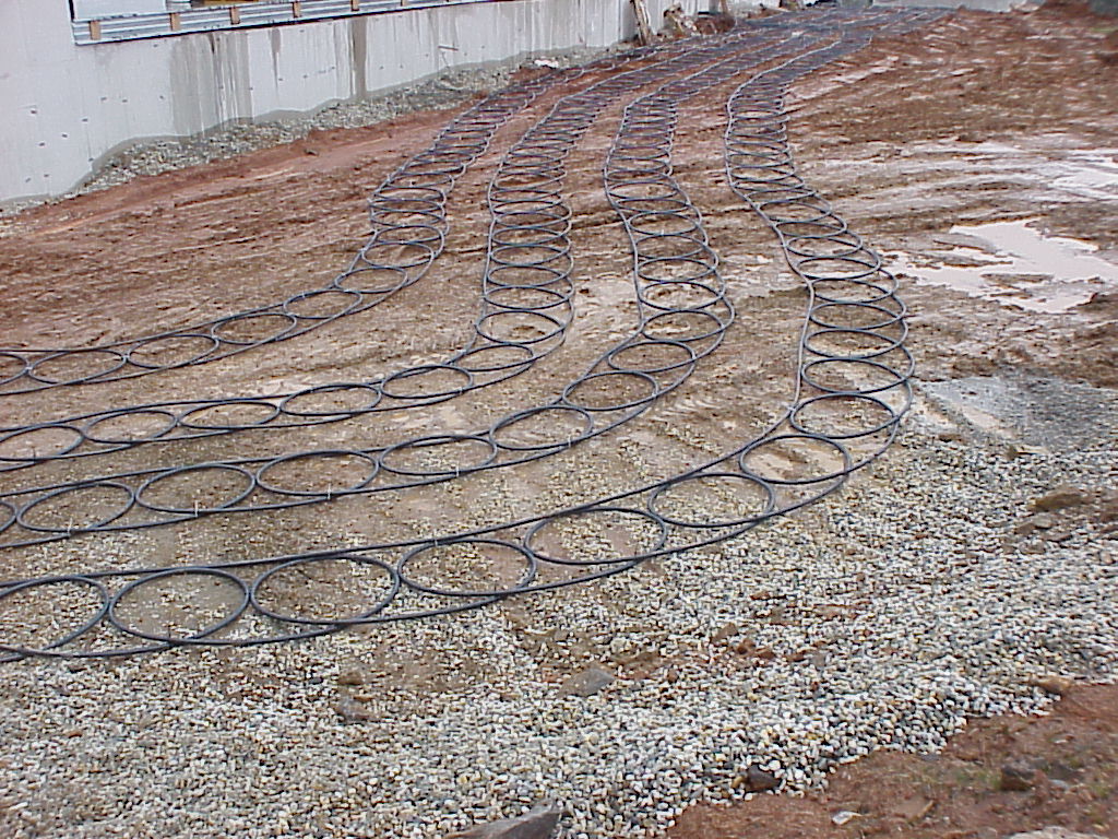

I put down eight, parallel coils, each 200 metres (660 feet) of 1" HDPE pipe.
Here's a view showing part of them before being burried under about 6 or 7 feet of dirt.

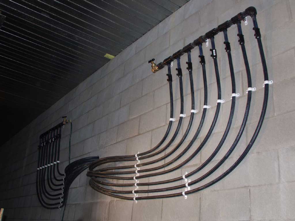

All 8 coils come in to two manifolds, "reverse-flow balanced", which should in theory at least, ensure similar flows through each coild.
By running more loops in parallel, the flow through each is less, so fluid spends longer in the tube and can gain (or lose) the maximum heat, but having them in parallel means you get plenty of flow and minimum back-pressure (so less effort on pumps)
Sure, you could se one looong loop, flow rate would be higher through the ground loops for a given number of litres/minute through the total system, but the fluids travel time in your loop (and therefore the time heat loss or gain) should be about the same.
