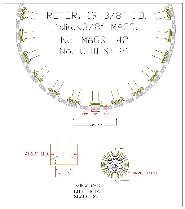

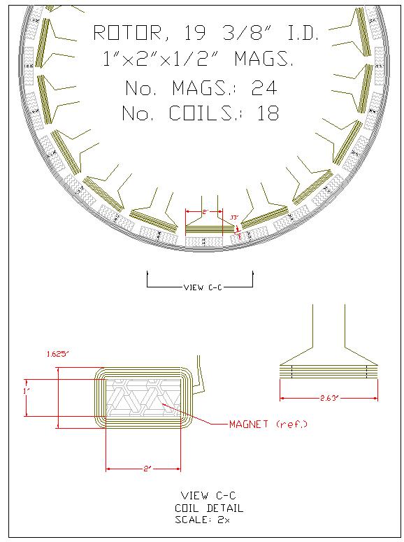

I'm getting started on a similar project, and would LOVE your input!
@ your statement: " - You can't use flat coils but have to "bend" the portion outside the magnet path (or wind the coils in a warped 3-d configuration) to keep the thickness between the magnet poles the same.
Winding warped coils is a real pain, and then you have to cast a stator with a groove under the magnet path and a fatter part where the outside-the-magnet-path portion of the coils sits.  Running the magnets in a groove like that inhibits cooling, too."
Assume winding the coils in a radial "3-D" form won't be a problem (I have a wood form already started, just need to trim it to size depending on my choice of mags).
After weeks of reading, creating pages & pages of WORD docs, and doing AutoCad drawings, I'm still unsure of my choice in magnets. Due to an extremely limited budget, I may have to add the inner rotor at a later date.
Also, cooling shouldn't be a problem, as I'll be punching 1x1 "fins" all around the top of the rotor "pan" for that.
I made only 2 drawings, one with 1x2x1/2 mags, and the other with 1inch dia. x 3/8 mags. I can buy ALL the 1inch dia. ones for inner & outer rotors, but the rectangular ones will have to be the outer rotor only at first. The config for the rectangular ones I hope is correct for 3-phase. The config for the disk mags is the simpler single phase (I think). I found a calculator for the flux density for each config, and surprisingly the round mags are higher! 3325 for the disk mags, and 3283 for the rectangular.
Your input is greatly appreciated. If the rectangular mags still end up at the top of my list, will it be worth a !!#$^ with only the outer rotor?
Also, there is a definite possibility this WILL NOT be powered by a hawt-vawt. I also only need 5amps at 200-300rpm (this is almost 20inches dia.)
Thanks again for any advice/input.
Rectangular Mag Config.
Round Mag Config.
Rural McG
