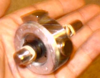

Latest effort: New USA 20" box fans have a new motor, I tried, it's no good, 38ma at 12V and 650RPM.  The new motor is a lot different, tiny, and not great.
The unmodified factory rotor, with 2 types of proposed neos, shown here...
http://www.otherpower.com/images/scimages/2050/Trade.jpg
But it works.
Still waiting to hear if the guy wants to trade me for something nicer.  LOL
So yes, the one JW shows is not so bad, IMHO.

Yes.  The old-style box fans where pretty nice.
The new-styles are not.
"Cheap" 1150 RPM single speed vent fan motors
should still be fine, and probably better.
Looks like an old-style box fan motor, but thicker.
