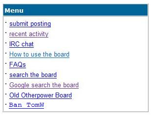

by ghurd on Mon Aug 18th, 2008 at 11:13:29 AM MST
Anybody know how to get this last button to work?
http://www.otherpower.com/images/scimages/2050/BanTomW.JPG
Sorry guys, and sorry twice to TomW.
Way too much time on my hands today.  Busy waiting.
I'll pull it in a day or 2.
