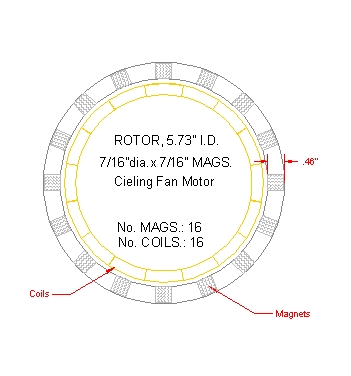

Here's a drawing of the cieling fan motor I wanted to convert. The rotor is only 1/2inch thick laminated steel, but I do have the material to wrap around the outside to build up for the flux on the backside of the mags. There are 8 more coils inside of the ones shown, I just didn't draw them in as I didn't know if I would include them in the finished product.
