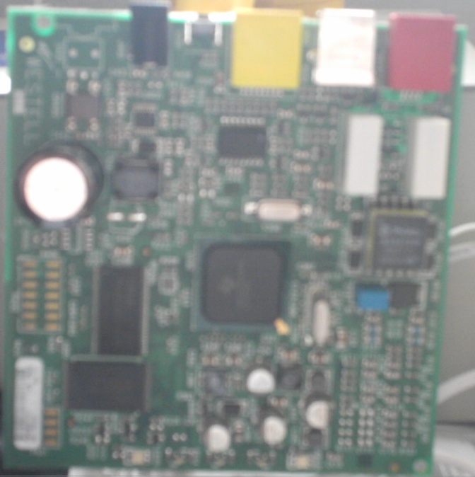

I opened the modem (an ATM, really). Westell C90-610030-06, Rev H
It has a full wave bridge just above the big round cap on the upper left. I plugged it into 13.2 volts dc from the Harbor Freight pdu and it seems to work fine.
I'm posting using it now. If I get desperate for power, I'll do it that way. What does 10.5 vac work out to full wave rectified? Is 13 dc underpowered?
10.5 * 1.414 = 14.8470
But there's also "droop" due to current pulled from the cap between the peaks.  DC doesn't droop.
There will be a regulator or two downstream to reduce the voltage to what is actually used.  So you're probably just fine.
