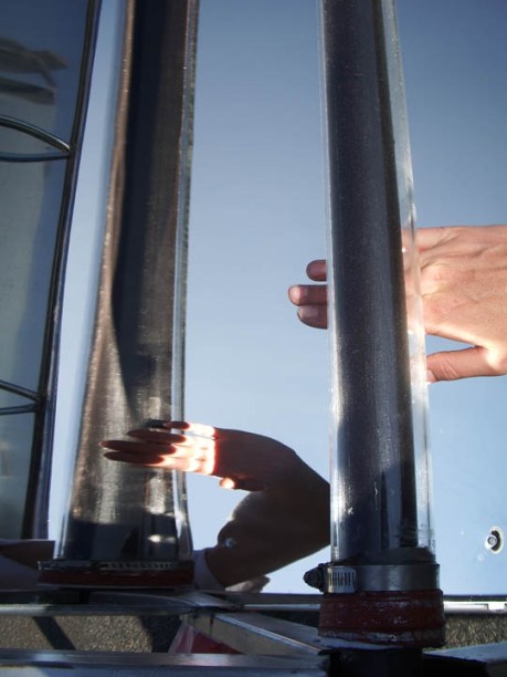

here is a link to more pics on the mit lesothos project: http://www.solarturbinegroup.org/media/
here is a pic of the pipe they used.  From the picture, it seems like their pipe is only about 1 1/2 inch at the most.  And, their trough is HUGE compared to yours.  I would think you could get away with a pipe of only 1".
Not sure what they are  using to mount the "glass" tube.  what is that grey stuff and the red stuff.  And why are they using a clamp?
