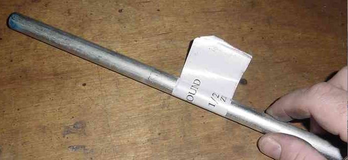

They look like this. If your really want copper ground, then hammer in rebar a little at a time and pull it out. When you get the depth you want, then hammer copper rod in the hole you made and water it in for good measure.

ok,
  phone guy rang instead of coming out, to be expected on a friday arv!
  He sounded bewildered when I attempted to explain. But then he said something like I need a "twisted cable pair" running from phone outlet to modem.
 However I drove a galv star picket in a few feet and grounded the inverter to that and it seems to at least improved the situation.
Now the ADSL only drops when I power up AUSTAR sat TV but then it comes good after a couple of minutes.
I can live with that....
especially seemin' it's friday arv and nearly drinkin' time ;p
cheers,
Ian..
