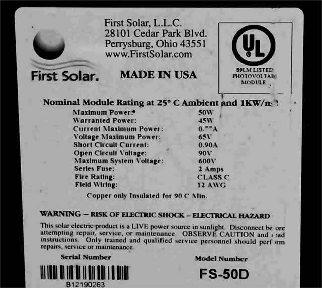

I have some new old stock First solar FS50 panels, they are 50 watt, 90VoC,  I will sell you some for $3.00watt plus shipping. you would need 4. if you are using a Grundfos SQFlex pump it would work well as 2 panels series, 2 parallel.

Those are interesting panels, at a nice price. Would work well with a MMPT.
I made a mistake, my motor is 2.5A, and using
http://www.sierrasolar.com/articles/water_pumping/calc_water_pumping.html
I've calculated either 94 watts, or 199w, depending on which pump head I'll use
(procon 2.5gph/5.3gph)

QUESTION:  At a maximum PV INput of 160v, those 50w Panels have an Open Circuit Voltage
of 85v.  Would that be an over voltage? Or do I use the "Voltage at mpp" figure of 58v, which is still pushing things for the LCB, although the motor can handle it.
I have 1000 feet of 2/0 wire to the pump, so voltage drop isn't a problem.
