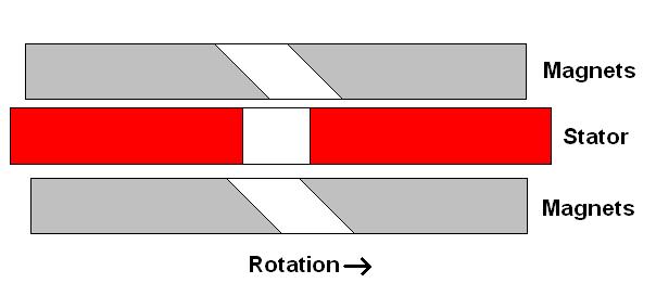

14.7 V at 300 RPM is not so bad.  A few extra turns of wire could have helped.  You could try a boost to harvest at lower winds.  All depends on your blade.
This is what I was thinking:
I didn't explain myself well.  That's what you get when I write late at night.  Holes at an angle which could help air flow to stator.
