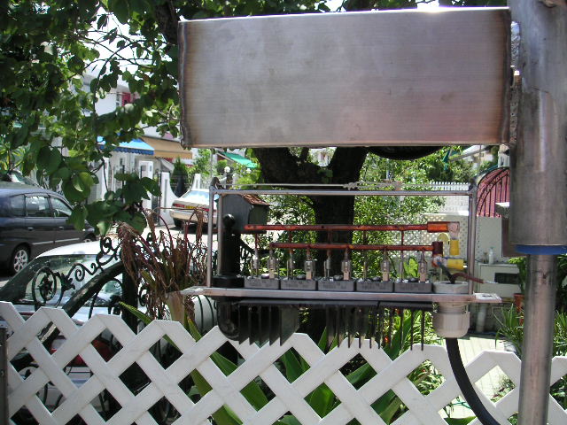

by David HK on Sat Sep 6th, 2008 at 11:53:27 PM MST
Additional photograph
David HK
Re: Hugh Piggot's 8' (2.4m) turbine - AC DC (3.00 / 0) (#6)
by milltech1 on Sun Sep 7th, 2008 at 09:14:55 AM MST
David,
     Very nice job, looks very clean and professional. Just one thing to think about- typically the heat sink is mounted so the fins are vertical to allow the heat to escape and keep the rectifiers cool. This may not be a problem but it's just something to keep in mind if your finding that things are getting a bit on the warm side, and again nice job!
regards,
Eric
Re: Hugh Piggot's 8' (2.4m) turbine - AC DC (3.00 / 0) (#9)
by electronbaby (roy<at>windsine.org) on Sun Sep 7th, 2008 at 07:12:35 PM MST
The fins are oriented to allow wind to blow through them and take the heat away. They will only be heating up when there is a lot of wind anyway. ....Or at least I think thats the thought here.
Have Fun!! RoyR KB2UHF
Re: Hugh Piggot's 8' (2.4m) turbine - AC DC (3.00 / 0) (#10)
by electronbaby (roy<at>windsine.org) on Sun Sep 7th, 2008 at 07:14:19 PM MST
After second inspection of the pictures, the alternator might be blocking some wind flow past the fins. Im sure it will still cool alright. David, please keep us posted. I like your design.
