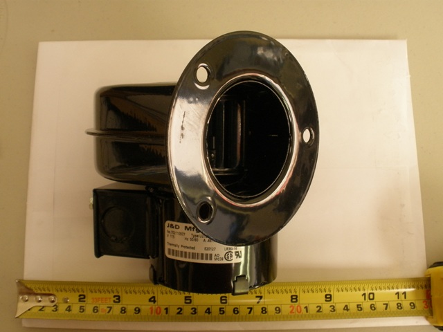

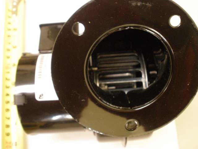

I will take a couple of pics of the fan tonight and send.  It is a small squirrel cage fan.  Besides a shutter mechanism, it looks like an automobile heater fan.

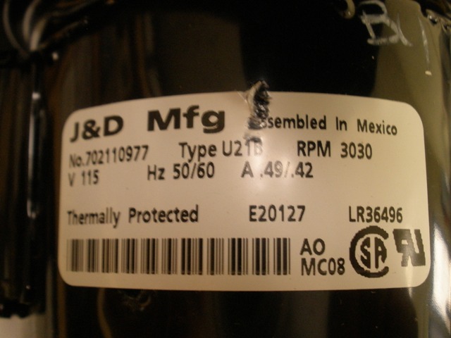

by mooselick7 on Thu Jun 11, 2009 at 02:35:25 PM MST
Ghurd:
Attached are pics of the fan in question.  If you know of a DC alternative, that would be great.
From another source, I am told there is a one way air valve that can be installed with a switch so that the silly thing isnt running all the time.  I need to dredge that up out of the net.
Thanks for your help.
http://www.otherpower.com/images/scimages/13166/P6110001.JPG
http://www.otherpower.com/images/scimages/13166/P6110002.JPG
http://www.otherpower.com/images/scimages/13166/P6110003.JPG
Re: Off grid Greenhouse Inflation Fan Application (3.00 / 0) (#22)
by ghurd on Thu Jun 11, 2009 at 03:12:05 PM MST
It looks like high volume and low pressure to me.
The one way air valve means it does not need volume, just some pressure.
If the plastic mattress-thing is anything like I picture it in my mind, it does not need much pressure at all.
Leading me to believe a DC muffin fan would work just fine.
And I believe this is a case where solar would be worth the initial cost.
Mental math this morning (pre-coffee) looked like about $70 / year for the grid fan.
Solar with junk ("boat batteries") payback was about 8 years and soon to need the 3rd set of batteries.
With a pair of Sam's Club golf cart batteries was 9 years But that had new batteries figured before then that would last a lot longer than the 9 year mark, meaning golf cart batteries worked out to cheaper.
That sounds BAD?
It only included the cost of RE related items.
It did not include the cost of running the grid to the green house.
If the cost of running the grid to the green house (I used $200 total cost) is deducted from the RE related costs, then even was at 4 years 9 months.
After than time you are coming out ahead.
If you have to pay someone to do the AC grid wiring, or the run is long, or it requires an excavator or renting a ditch-witch, then solar may work out cheaper the first time the fan is turned on.
The one way air valve has me wondering if the initial cost could be reduced even more.
To know what is what, need to try several DC muffin fans and be sure they are up to the task.
Before spending money.
