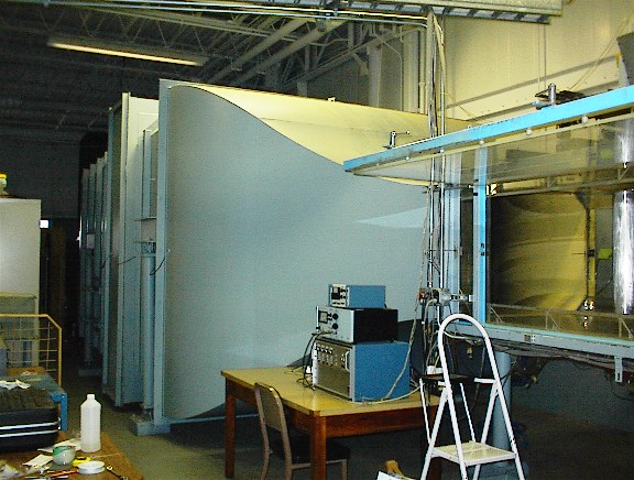

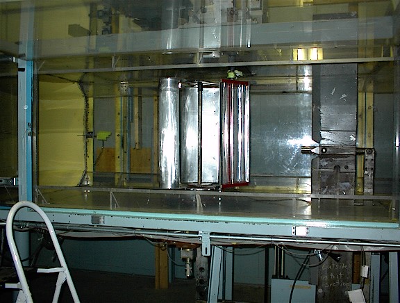

  Well, after 3 days and a total of an hour tunnel time all is confirmed.  First a couple shots of the tunnel.   First one has the turbine set up and ready to go.   The second gives you an idea of how massive this thing is...
  The tunnel is a closed loop which goes outside the building all the way around to the back side and re-enters the building.  Everything is computer controlled... quite impressive.
  We dialed it in to match the output of my tunnel and I found I was 1/2 mph off in my readings ( to the good I might add ;o) ).
  There were several tests done using windspeed and pressure.   Most of the calculating they did because, to be quite honest, I had no idea what they were doing.  When they were calculating pressure before and after I was lost... The windspeeds were calculated from inches of water which they said is more accurate.   And lastly the tests were performed by measuring ft/sec.
   So here are the numbers for how well the Lenz2 converts wind energy to mechanical energy.  Firstly a refresher of the unit that was being tested...  it stands 2ft x 2ft ( 4 sq ft total area ).  I haven't changed the wings to the new version but there are winglets added to this unit.   I wanted to get data on the original wings before proceeding.
   Here we go... I'm going to keep it in mph since it's common to all of us and easy to understand...

    The tunnel test section is 3ft tall x 4 ft wide.   The professor, Dr. Liu, worked out the details on blockage and these were added to the final calculations.   For the most part I watched and learned.  They wanted to disassemble the unit and run the wings through a series of lift/drag tests at various wind speeds, I would have loved to let them do it but my budget would only allow the basics.
    I did, however, study the balance beam mounted below the unit the wings are attatched to and it appears a smaller less technical ( computer controlled ) balance and measure system could be used for this.   I'd like to build one for my tunnel and play with some measurements.  The mechanics of the beam is quite simple and as long as everything is balanced the measurements should come out reasonably accurate.  Another toy to play with...
« Last Edit: December 01, 2005, 07:16:17 AM by windstuffnow »

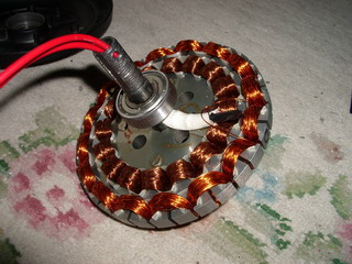

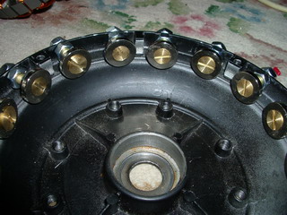

At first I thought this looked like something I have here, then I see there are outer coils and inner coils. Is this a rewind you did yourself and any specail cutting on the  stator?
 Mine has 2 sets of windings, both coils are right together offset by just a toothe or so.
 My lathe has not been set up here for a while, I need to turn the outer ring to mount the mags in still.
« Last Edit: December 02, 2005, 03:48:33 PM by nothing to lose »
wayne
  • Posts: 94
Re: Lenz2 wind tunnel tests are done
« Reply #22 on: December 02, 2005, 04:04:59 PM »
Its just a ceiling fan motor, here is a pick on the outside. Have not spun it up yet, but by hand get 3-4 volts.
Wayne
