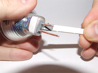

Step one - empty the bulb.
Start by taking a small screwdriver and twisting its tip on the white cement you'll see around the bulb's pins. This cement is very fine and will start crumbe as a fine powder as you keep twisting the screwdriver's tip.
Proceed with this until you get enough cement out for the next phase.
Patience is a virtue so take you time and be gentle since the bulbs can easily break if you force you way in with the screwdriver.
Action time. Take a hammer and after you got out out as much white cement you could, put the bulb face-down on a flat surface. Hit the two pins with the hammer, in a easy but ferm manner. The bulb inside should fall on the table leaving the reflector empty.
Some white cement will remain but that's OK, it's not so important and might even be useful later.

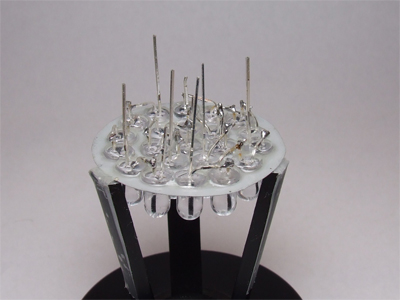

Place the aluminium disc in some holding device (I have one like the one in the photo and it's great). Be creative with this, basically you have to hold the disc by its outer rims. For example, a pipe section with proper diameter will do.
Insert the Leds into the holes with the legs up and arranged in such a manner that one cathode is next to another anode. This will make soldering easy. Don't forget this or you will have great difficulties soldering them according to the scheme.
Put one tiny drop of Super Glue on each led margin and continue arranging the other ones. WARNING! Take care not to accidentally apply super glue on the LED legs. When you'll have to solder the legs, these will be heated and the glue will give off a little colourless smoke with major effects on your eyes! I know, i've done that and couldn't stopped crying for one hour. I think that's how they make that tear gas after all ...
After all LED's are placed and glued, put compound glue around each LED for a solid result. It is necessary to glue them firmly since the legs will have to be bended and you'll risk some leds to come off otherwise. (that's experience speaking) Now let the glue to harden before proceeding. In my case this meant 24 hours but the result was worth it.

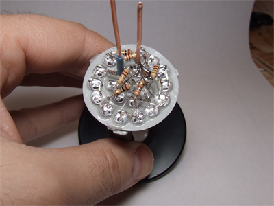

Step three - making connections

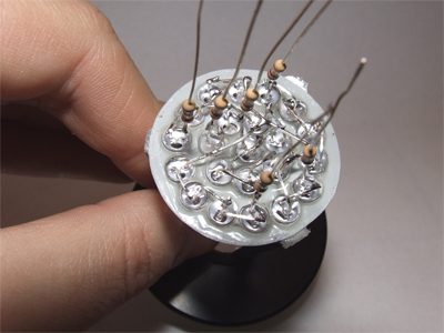

Take one nailclipper and cut out the LED legs, keeping in mind that one anode will have to be bent over to the next cathode and so on. Also take care not to confuse the two of them. You can check that with one multimeter set to diodes. As the scheme advises, I'll have to make 5 strings of 4 LEDs each and one string of two. Since I arranged the leds in such a fashion that one cathode is next to another anode, this operation is much easier. After soldering one string, keep the end legs at different lenghts to easily identify the + and the - end.
Take the nailclipper and cut the LED legs and bend them to the next leg. The + goes to a - and so on until you complete a string of four. Then start a new string.
When you're done making all the strings according to the scheme, you should have six + legs longer than the six - ones. It's time to solder the resistors. But first bend the longer legs toward each other and solder them to have all the + legs connected together. This should be done over the other connections keeping some distance to prevent short-circuits. The resistors should be soldered vertically to the - legs.
When soldering, try to be as quick as possible sice you'll be heating the LED legs close to their base and too much heat will damage them.
Now solder the resistors legs to each other in order to get a single - that goes to all the strings. Try to keep a low profile so that the whole thing will fit the bulb.
Now solder the final legs. Use copper wire (thicker) and keep in mind that one (-) has to be shorter.
The whole thing should now be pretty rigid since so many solderings were made.
But for your peace of mind, use a hot glue gun to fill the gaps so that no wire accidentally touches another. This is optional.
