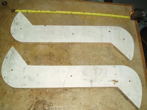

Although I'm more a programmer than a carpenter (or whatever the equivalent in plastic is), I'm having a small go at understanding a simple drag-type S-VAWT made from an empty drink bottle.  Not to drive any sort of generator, just to move.
At the moment my little prototype is becalmed by a complete absence of wind (and a poor bearing) though I'm sure I saw it twitch a few mm in the right direction when we had a little puff of breeze.
My moderate idea is this: for small VAWTs, rather than have them sat on the ground with the motor bearing taking the weight (ie in compression) would an alternative to be to suspend the VAWT blades from the motor spindle (ie in tension) with the motor on a universal joint and/or the blades suspended on a piece of slightly twistable cord to avoid some of the side-to-side wear/torque?  Getting everything slightly off the ground is likely to improve wind speed/flow a little, just to start with.
The bottom of the blades at the centre could be fixed to the floor via another cird and bearing, or simply allowed to hang free, maybe with a small weight.
I'm think of constructions from the size of a Chinese lantern up to a plastic barrel VAWT.  Maybe good for Watts through to tens of Watts in low wind speed.
Any chance of it being do-able or sensible?

Well, goodness!  I have something that turns quite well: a lungful of air has it turn at least 2 or 3 times.  Any most of it should survive rain, though is otherwise quite fragile.
And, through ham-fistedly running out of other alternatives, the bearing is at the top, with the whole device hanging down from a 'sprung' pillar.  A very small gen could fit in there at the top of the post, with wires running down the post.
I'll take its photograph 'planted' in my garden tomorrow, and see how long it takes to fall apart.
Then I can think about a real VAWT generating my usual milliWatts, when we get any breeze at all...
In any case, I'll see how quickly this one rotates.

The outer edge of a drag type rotor like a savonius will be essentially the same as the windspeed when it's unloaded.
For a 1 foot diameter rotor the circumference will be 3.14 feet so in a windspeed of 10mph, the outer edge of the rotor will be going 52800 feet/hour or 88 feet/minute.
Dividing the circumferencial speed by the actual circumference gives you 88/3.14=28rpm
I believe optimum loading for a savonius is when it's running at a tsr of 1/3 so to extract maximum power you'd want your alternator to hold it down to a little over 9rpm in a 10mph wind.
Hope this helps

S-vawts are hard to break down with numbers. I don't know of any way to sit down with a piece of paper and figure out exactly what size/configuration of an s-vawt you need to build get a given amount of power out. I think it's ok to go by 'feel' though...
You can't really say an s-vawt made from 6" pipe will spin this fast in this wind. Besides the height, you've got weight, air gap, bearings, general build quality, load, etc....lots of things play a part, even with a simple-S design.
Then, are you really talking about a simple Savonius? To me that means each blade is a half circle, the gap is about 18%, the blades don't overlap, there's likely a center rod and you've got end plates. Or are you talking about a modified simple S?..
I consider my quick vawt to be a modified simple S...the blades aren't half circles (though they could be), they do overlap a little, there's no center rod, the gap is totally configurable and a bottom plate is all that's really mandatory (to protect the bottom bearings from the weather).
Past about that point you get into the more complicated designs/problems and all hell breaks loose. Then you start pondering the aspect ratio..wider is better for low winds but is lower rpm, tall and skinny for high winds and high rpms. Oh, should I use those "J" looking blades?..those are more efficient. Etc.
There's just so many variables.

« Reply #18 on: October 04, 2007, 08:10:46 AM »
OK, some pics of this first S-VAWT prototype.  Yes it's all wrong, etc, but it's a start!
http://gallery.hd.org/_virtual/ByCategory/mechanoids/turbine/wind/tiny/vawt/
« Last Edit: October 04, 2007, 08:10:46 AM by DamonHD »
