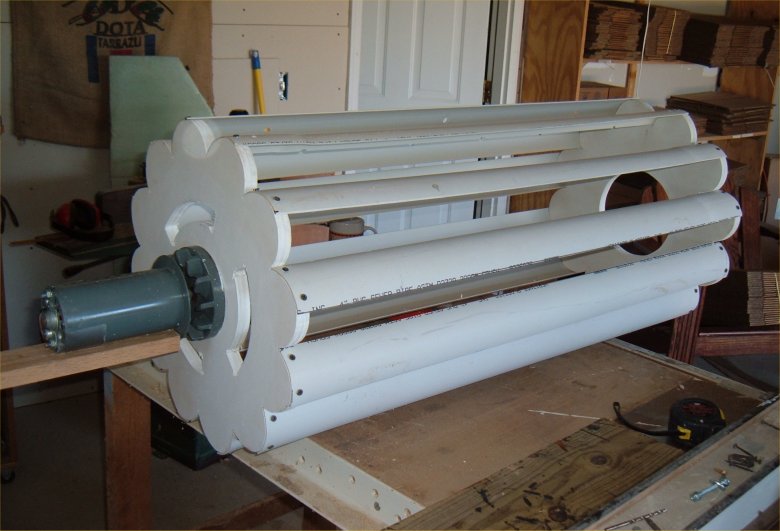

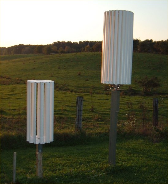

The following are the two "squirrel cage" Vawts I've been working on lately. I think they have alot of promise. Even though they are my own specific design, squirrel cages have obviously been around forever. I have seen one made out of sheet metal, but never 4" PVC "drain/sewer" pipe and 3/4" treated plywood. I quarter saw ripped the 4" PVC pipe with my table saw. So thats 4 pieces per pipe. Each piece is only 3 inches wide. This is 'solid' wall pvc, so it is very 'bendable' and "snaps back" well, which is nice.

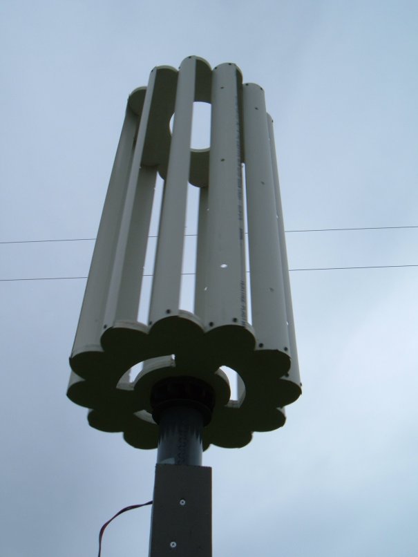

The first two pictures are of the small Prototype Vawt-- it has 12 blades and is 18" diam. x 39" high. I really like what i am seeing so far from the testing!
The normal generating rpm range of it is (or;will be) 200-600 rpm. Right now it is attached to a high rpm treadmill motor , so it does not reach 12v cut-in to generate useful power. I may or may not make an alternator for it. It was really only the test prototype. I kept the wires 'shorted' and the rpm looks to be the same as when I allow it to freespin! It just survived what had to be at least a 70mph wind during a terrible thunderstorm last week. It kept perfectly steady and as straight as an arrow and was probably going 1000 rpm with the wires shorted together!! It was AMAZING as I watched the whole thing happen from the window. So it probably has twice the torque of my 4' hawt in the 100-600rpm range. When I short my 4' hawt treadmill motor/generator, it takes over a 40mph wind to turn it!!(or;to break it free from stop and/or stall)
And now... comes the pictures of the 'Real' one. I have named it the "VERTIGO -SC/100".
It better do at least 100 watts! It has very nice torque.
It is mounted to my small trailer hub alternator. (But the Stator is not done yet. Monday, my wire will FINALLY get here, and I will make the stator!!)
It is the same quarter sawed 4" PVC as the prototype. It is 2 feet Diam. x almost 5 feet high. (2" less than 5', because the 10' long pipe has a 'flaired out' 4" part on one end. I cut that off.)
So it is technically 4' 10" high. There is NO center pole in the middle. It is totally supported by the 24 blades. The proto has no center pole either. It is quite strong and actually can bend if it has to. Here is the template. Now I can make more quickly if it performs well!

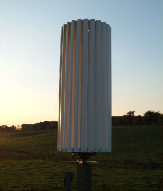

You can see the angle I chose for the blades. It is my current theory that the wind flows into and around the center and 'swirls' fast and actually EMPOWERS ALL the 24 blades forward, for maximum TORQUE per revolution!! (unlike most if not all other VAWT types) Also, the air resistance is very small on the opposing side of the rotor since the blades are so close together.

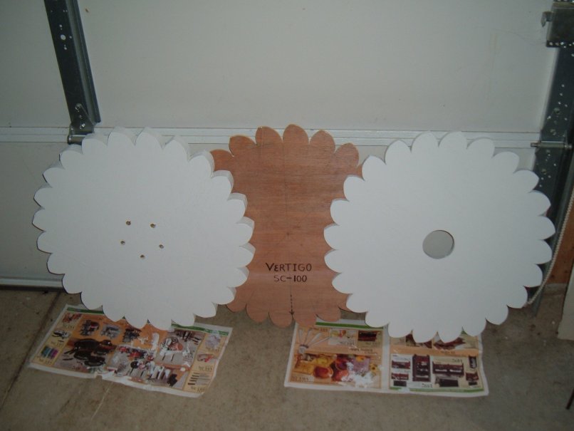

The bottom is the one on the left and it has a DOUBLE stack of 3/4" treated plywood glued and screwed together with Waterproof wood glue. Yes, its heavy, but it gives alot of extra support for the blades. This big rotor weighs about 45 lbs. The small prototype rotor only weighed 14 lbs. The small hole in the middle of the top helps with air flow to get more power in higher winds. (I believe)
If the treated plywood don't hold up, I will then weld up all steel centers and no wood. But right now I can see what kind of power I will get out of this rotor.

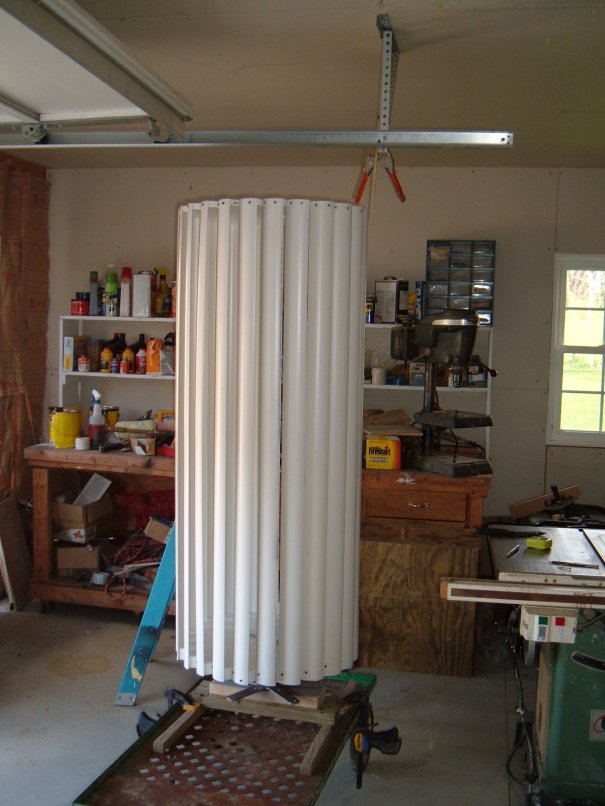

This is how I 'centered' the whole cylinder shape. I screwed the top on first. Flipped it over and only put one screw in each blade at the bottom. Then kept pushing it 'square' as I put the second screw in each blade. Understand?

what sort of angle have you set the vanes at ?
it looks to be about 45 degrees to a radius line.

Thanks guys. Appreciate the comments. After I paint the hub and alternator white and mount it to the 10' high white (steel) pole it will really look nice close to my off-white house. It looks really neat when it spins. Everyone thinks so including the mailman, UPS driver, and my one neighbor, and many,many others. They have never seen anything like it. First they ask WHAT it is, and then ask if it makes electricity. If I wanted, I could fib and tell them it is a 'Doppler Sonar' that attracks bats to eat mosquitoes or something. They would WANT one then! But I quess I'll tell the truth.(for now that is)
That soft 'drain pipe' PVC cuts REALLY easy with a tablesaw. I just had my normal 24 tooth rip blade on there and 'free hand' ripped the pvc, simply using the fence as a guide. Those 10' sections of 4" PVC drain pipe are only $7 at Lowes. Make sure they are straight. I had to make the guy go and get me some 'staight n' fresh' ones at the back of the store. When I told him why, he was AMAZED and got the manager and they both want me to bring photos of the windmill next time!
That soft PVC cuts like butter! Not even one screw up! One could also use a 'Orbital' jigsaw with a plywood blade to cut them also but it would take longer. Of course you have to make lines down the pvc with a black marker. Never try to cut the PVC up in the air on the tablesaw though--always keep it DOWN on the table as you're ripping it. Also, I crosscut the pipe with a manual wood handsaw.

It looks like the blades are at about a 45 degree angle.

The only thing I don't get is the holes in the top and bottom. It seems to me that without those holes the air would have to exit out the sides and would give it a bit more oomph. It would be interesting to see for sure if there's a difference either way.

i asked about the angle you set the blades to as that would probably qualify as  the angle of incidence and is very important.
i would avoid any sort of top bearing or secondary generator at the top .
that would require a support structure which would ruin the visual impact.
if you find that there is a tendency for the mill to get "tippy"
then try this ,
 move the base support disk(the one that ties into the alternator) from the bottom up into the middle to keep it hidden and equalize the loading.
it would require building another end disk  for the bottom but that would be a small price to pay for a stable machine.
you might need a larger center hole in it so it can easily straddle the support pipe.

   Thanks Feral. I appreciate and benefit from EVERYONE'S ideas and experiments including yours. Thats the great thing about this site!
You bring up a good point. I thought about that too,,,concerning the hole(s).
I will tell you what I have observed so far. You are right, the cylinder APPEARS to turn alittle faster in the BREEZES (under 10mph) WITHOUT any holes in the top or bottom. Thats the way I had my Prototype in the beginning tests. I was always aware that most or all of the commericial models had holes in the top and bottom. But I wanted to see the difference.
The holes (I believe) are to ALLOW more air circulation thru the cylinder during higher winds , which allows getting much more power in the bigger winds. If you don't have holes, then, at some point as the winds increase, the 'swirreling' air and pressure inside the cylinder cannot leave fast enough, and a percentage of the wind would simply flow AROUND the outside of the rotor. (at least thats my belief at this time)
On the other hand, if the hole(s) are TOO big, you could send too much of your low wind pressure out the hole(s) and miss out on some CONSISTENT low power potential. (As you said)
So I actually believe now, that the hole in the top of my Prototype is much too large. I would only make a 3" hole now and NO holes in the bottom.  The big VERTIGO rotor has only the one 3" hole in the top.
I am glad you brought up that point, because I have noticed a difference. I will keep doing different test to see which is best. Also, having less 'air flow' MIGHT help regulate or 'air brake' the rotor in extreme wind conditions. Which MAY be good!(IF it don't sacrifice power below that point)
 I did not have the holes on the Proto when that 70mph+ Hurricane like wind hit it last week. So I must keep doing testing.  Thanks

Sorry, I was incorrect about the angle. I'm not too good at Geometry. Heres a picture to show the angle. Each blade is actually 58 degrees:
Yes, thats a line from the outer point of the blade to the inner point of the blade. Be the way, the rotor obviously turns CLOCKWISE.
Today, I'm getting better breeze (so-called 5-10mph) , and it is REALLY going nice!

 I noticed on the smaller one that you can see through it and on the larger one you can't. I'm just wondering if that will make a difference? The pipe is the same diameter on both. With the bigger dia and more blades it closed the gaps up. I wonder what would be the difference if the pipe was scaled up to make the gap the same. It has something to do with the holes in it too I would guess.
« Last Edit: October 06, 2007, 01:22:55 PM by jmk »
CmeBREW
  • Posts: 615
Re: "Squirrel Cage" VAWT progress !
« Reply #27 on: October 06, 2007, 04:17:40 PM »
Thanks JMK,,
      I have to just quess with the making of the stator. The stator will be thin, only 3/16" thick for maximum flux strength to try and raise AMPS  quickly since the rpm range is usually limited to only about 50-400rpm on VERTIGO-SC100 and about 100-600rpm on Lil'Vertigo-Jr.  I am using 20ga. wire. My quess is probably around 100 turns. I would like cut-in to be around 50rpm on the big rotor. I may have to remake the stator again to get in better. This will be only my second stator. And my first one was small. I can see the rpm easy upto 120rpm simply by putting a piece of duct tape on the bottom of the rotor and laying in the grass beneath it with my stop watch. The prototype small one has holes in the blades because that pvc is from another project that didn't become fully realized. (translation: That project FAILED and crashed and burned!) So the holes in the pvc blades mean nothing.
The blade spacing is something you'll simply have to experiment with yourself. I do not know much at this early point. I just figured that more blades (upto a point) could mean more torque per revolution in the lower wind ranges--which is what I want.
The Prototype rotor probably goes TWICE the rpm of the bigger one. But the bigger one will probably do 4 times the over-all watts. The bearing in a small trailer hub. It has the two roller bearings in it. It is strong enough for this. 1000lb capacity.
Not a drip of rain will ever get into the bearings.
Yes, I hope many begin making these, because I have alot more ideas myself I want to try. And there is absolutely NO REASON these type mills shouldn't go ANYWHERE including down town, in the city, on one's roof, in one's yard, on the corner of the house, on buildings, or anywhere else for that matter!! Personally, I'm for ALL type mills EVERYWHERE. But I hope enough people get together to finally over-turn all those baseless, unreasonable, worthless codes and ordinances once and for ALL!!
(except perhaps for the few mills that make ALOT of noise)    -Thanks JMK.

Each blade is less than one pound. In fact, all 24 blades on VERTIGO weigh 19 lbs. total. If a blade were to ever hit the air it would slow up sorta like 'a feather'. A light pine blade would probably do the same.  As you asked, I threw a pvc blade high up in the air like a spear, and sometimes it comes down slowly sideways spinning horizonally, and sometimes more straight. Of course there is not a breath of breeze today! I believe it is about as "safe" as you can get. The rpm is only half that of a small Hawt. That 'solid' PVC will not snap in two--it is very flexible. If you stand on a piece it will bend, but not break-- unlike that 'plummers' type PVC. That stuff is more brittle and it will 'snap' in two.
I admit though, the heavier blades of something like a Darrius Vawt spinning fast, makes me nervous. In fact, I am disassembling the big heavy plywood Vawt (41" diam) I made the video of on Youtube.
The blades are WAY too heavy and a big wind would easily tear them off without some kind  of an rpm control or auto-braking system. It is too much trouble to mess with. It was an IMPRACTICAL design, but I learned ALOT from it. This new design is far better, and even though it is hard to believe, it seems to actually 'self-regulate' in high winds AND actually 'BALANCE' ITSELF in high winds when spinning fast!!
The prototype is mounted to a treadmill motor as you seen in the photo. The shaft on it actually bent alittle bit bent. So the rotor is off about a half an inch at the top when it is spinning in normal winds. But when a big wind hits it (above about 20mph) it straightens up perfectly when it is spinning fast! That was unexpected!
