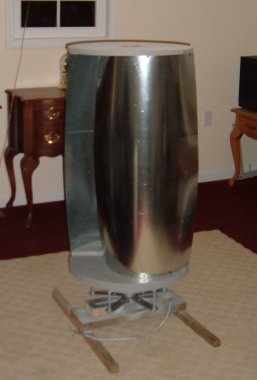

Hello again friends,
    Since I already had made the alternator a year ago, and it was sitting under my desk in my bedroom doing nothing all winter, I decided to try again at making a simple Vawt on top of this small trailer hub alternator.  This Vawt is just the common "S" two blade made from 26 ga. sheet metal. It is 2' diameter by 3 feet high. (only 6 sq. ft. swept area is tiny though)
The rest is just 3/4" treated plywood. I intend to paint the galvanized sheet metal brown later.
Here are the two videos. I just put it up yesterday. Haven't got to see what it will do in big winds yet.  I hope for 10-40 watts max.  But who knows. This is a terrible location actually and the winds are coming intermitently from the worse wind direction today.  I will move it to a better location later and re-record it on a better BIG wind day later.(IF it holds together!)
 Winds shown are about 5-12mph I guess.  The Ammeter is hooked in series with the 12v battery.  It is mostly just trickly charging today, with it doing a lot of 2-5 watts.  In the second video, you see it starting out over 5 watts. (.4 amps @ 13v)
http://www.youtube.com/watch?v=eUL4ZhX352Y
http://www.youtube.com/watch?v=ujTfAV4GGC4
But I am almost certain it is still in mechanical STALL.  I need to get more length of wire to try and get it out of stall more or get some little 20 Watt power resistors and experiment with that.  You see the small speaker wire length of wire in the video I am using to try to get more out of stall.  But I don't think it is enough yet.  When I unhook the wires, it free spins quite a bit faster actually.
I'm learning that Getting the right Torque rpm range is very tricky with these Savonious Vawts.
The follow pic is when I had it in my living room before putting it up.
A cheap box fan turned at it starts it up VERY easy from ANY angle and turned it 60rpm.  I think the rotor so far weighs about 30lbs.  But I believe I will add some metal or wood supports on the sheet metal blades to 'straighten up' the blades so they don't boe out so much.  So far I don't see a need for a center rod in the middle, but I could be wrong when the big winds get here again. We'll see.
The diagram below is my Super Basic Theory on the air flow of this Savonious. The invisible 'Positive pressure line' always heading in the positive direction in relation to the center axis is VERY important or it would cancel even worse! The rotor obviously is turning clockwise.
It seems to me, the right side of the rotor cancels about 25 percent of the potential, with say, 75 percent going in the positive (clockwise) direction. Thoughts??
Anyway, It is all good fun and ALWAYS fascinating to see any windmill produce a little power to use later.  I think I will keep messing with this one and trying to improve it , because this Savonious Vawt looks to be the most promising Vawt yet I have attempted.
I love the looks of these I must say, and I can always put it on a better looking 12ft high pole with the wire inside.
Any thoughts or questions appreciated!

« Reply #1 on: April 20, 2009, 06:47:57 AM »
Stove pipe has an interlocking hem that so the
edge already has stiffened edges.
....or you could make a simple sheet metal brake....
(like a board and some c-clamps) bend the edges
over)and you wouldn't need any sticks to stiffen
the edges.
  Make it twice as tall on a shorter tower....
if you have the alternator wired for high current,
connect it for higher voltage? instead ? if that's
the highest voltage mode try charging a
6 volt battery?
  All kind of ideas.....with VAWTs....don't try
to improve on this...just add to it....make it
bigger !
  In the meantime pedal away on the pedal machine
keep them batteries charged ! LOL !

Two suggestions:
 - Try the Sandia Savonius profile.
 - Put an extra form in the middle to support the blades against bowing and make them hold their shape under load.  (It can be supported by the blades.)  Essentially no air goes up-and-down in a non-helical Savonius design so it's not costing you power (except for the tiny amount of cross section it blocks.)
« Last Edit: April 20, 2009, 02:29:48 PM by Ungrounded Lightning Rod »

Good work,cmebrew,looks fine.
I agree with ulr,some reinforcement in the middle wouldn't hurt.
I think the profile ulr talking about is called 'benesh',somewhat betyter performing and somewhat faster then the classical savonius.
These high rotors allways make me worry about forces at the bearing,with strong winds,hope you made it strong.
A few watts is allready better than most vawtbuilders have achieved :)
Keep us informed about future improvements.

Thanks fellas for the helpful comments.
I most likely will try the center support and blade (outside edge) reinforcements in the near future like you suggest.  Today just happen to have some bigger winds and I got to see some more performance characteristics.
It is strange. It must Still be in mechanical STALL, I just can't believe it. It is very frustrating.  I went and bought a 100ft. (16ga/3 wire) today to add in series with the 40ft cord (before the rectifiers) in order to try and bring it out of mechanical STALL and it seemed to help some but not enough.  In one big gust it did do 14 watts for a few seconds and then went back down to 6 watts.  Mostly it maintained only around 4 watts. But today was very windy. (gusts up to 25mph)
So it is still somewhat useful for my small 12v system even as is in this horrible location.  I would say it does 10-100 watt hours depending on the windy day.  But I know it will do better if I can get it a little more out of mechanical stall. (It takes TOO much TORQUE to turn the alternator)
My little 32" diam. (high solidity) Hawt above my roof did probably twice this today in Watthours. (but it is in a somewhat better location so who knows)
Today I let the Vawt free spin for a few seconds during the strong winds, and it spins much faster and then I hook the wires back together and the ammeter briefly shows over 40 Watts and goes back down fast.
 I thought the 100ft cord would loosen it up and trade some of that hard to turn torque for more speed. It did some. It allowed it to make a little more power. But this 20 pole (3-phase) dual rotor alternator I made sure requires a LOT of torque to turn to even get 1 or 2 amps. Right now, the 12-13v cut-in is about 70rpm.  Its like the amps (Amps seem to be like TORQUE to me/ Volts is like SPEED) wants to raise TOO quickly.  You can't go with bigger diameter to get more Torque, because it will be too slow then.  I need to 'Thin the Torque out' the way it is somehow.
Does anyone know how I can get this damn alternator out of stall?!! I hardly want the voltage drop of a 400 ft cord wrapped up in a big coil.
Maybe I will get and try some little power resistors next and see what if that helps.
-If anyone ever thinks of anything else you think even might help, it would be greatly appreciated.  If I can get it better, I will show another video here
 -Thanks.

Those winds from the wrong direction frustrated me too, the howling in the tree tops, and nothing to get my windmill spinning.
If the alternator can be configured Jerry rigged, it will take more RPM for cut-in (120?), but less torque for the same amps.
You said "anything".
I have an unusual idea.
Try disconnecting one phase.
« Last Edit: April 21, 2009, 05:13:13 AM by ghurd »

"Today I let the Vawt free spin for a few seconds during the strong winds, and it spins much faster and then I hook the wires back together and the ammeter briefly shows over 40 Watts and goes back down fast."
sounds like  p.w.m. is required.
the mill should be made strong enough to live through the strongest winds without load
i don't get what you mean by mech. stall.
i have never seen a savonius with that much of a gap between the halves.
i don't mean the overlap.
 i mean the distance from one half to the other across the center.
it looks like about 30% of the width.
whats the thinking behind that?

Can you open the airgap and run it faster ? I know little about VAWTs but without having to re-wind your stator or change your alternator design altogether I would think adjusting the air gap might be worth a try. Other than that it seems like the same old match the alternator to the blades to the load routine. Great work, you and Ed seem to be paving the way to useful power with the VAWTs.  Dave B.

I would agree with Dave on this. My now 8 foot turbine used to have a 10 foot prop that got destroyed. A simple prop swap from 10 to 8 foot gave dismal results until I opened up the air gap to give the prop its head so it could get up to some RPM. After that it performs nicely.
It was a bit amazing how much air gap changed cut in.
Definitely try that first. It is the easiest and cheapest way to alter cut in on an already built unit, near as I can tell. It was advice from DanB so not my idea but it worked beautifully.
Good luck with it.

I made another quick Video after work today. Wind was a little better. I made two videos but The better video didn't play right, but this one is OK.  You can see the Ammeter better in this one. IT is doing a fairly steady 4-8 Watts in the video.  I didnt get to watch the Vawt today but for a few minutes, but it did 16 watts during one big gust.  It went above 1 amp several times, but I didn't have time to wait around to video record it during stronger wind gusts:
http://www.youtube.com/watch?v=n-NcM_FGz3o
Yes, I had already opened the gap last year during previous (Humiliating;fruitless;etc) Vawt testing. The magnets are only 1/4" thick and the mag to mag air gap is 1/2" now , and the 12v cut-in rpm is about perfect now. With the 100' cord I just added yesterday (which I will need this anyway when put the pole and mill in a better location away from the house) the NEW cut-in looks to be somewhere between 80-90rpm. (up from about 70rpm)   Cut-in Seems to be good.
So I really would rather not raise it anymore or it would miss quite a bit of Trickle charging in the lower wind days and of course, inbetween gusts of wind.
I think I will try the power resistors next and see what that does. Thanks for suggestions.
I just found out today that the diameter of the Vawt is actually 21" inches. (NOT 24" // So it is actually only about 5.5 sq. ft swept area)
Sorry, but I forgot I had jigsawed off the 'ears' that my previous 16 blade PVC 'Squirrel cage' Vawt had.  BTW, I never could get that Squirrel cage Vawt to work that good at all. Evidently, most of the wind would just go around it and the wind inside it did not do what I had hoped it would.  I will NEVER attempt that type Vawt again.
It seems to me These simple "S" Savonius Vawts has the biggest chance for success.(for a Dumby like me anyway!)
I am not going to bad mouth Vawts so much anymore.  I can see some potential now-- it's just that they are NOT so simple. Sure would be nice to have a testing wind tunnel and smoker to see whats actually happening with the cycle rotation!
(But of course, there are still a PLETHURA of Vawt SCAMS on Youtube I do NOT believe in the least!! But there are a very few there I do believe in)
Trying to charge into a 6v batt with this Savonius does not work well since it requires even MORE torque to turn and the cut-in is way TOO low.  I tried it. It sucked.
Also, disconnecting one of the phases DOES allow the VAwt rotor to spin faster, but it looks like the power is alittle less actually. (not much less though)
So Who knows. I will keep experimenting and research that Benesh Sandia Vawt rotor and see it I can improve. But I am going to stick with these small "S" Vawts myself.
 I know it is not much power, But even the way it is now, I am happy that I finally got one that looks really neat and actually makes a little bit of USEFUL power for my small system.
-Thanks again. If and when I improve again I will keep you posted.

This first picture is the profile of the Vawt in all the Videos above (It is half over-lap):
The picture is of the bottom that bolts to the hub bolts. It worked OK I guess.  But I wanted to try something more like the "Benesh" Vawt (Below) and so I cut down the arc a couple inches and widened out the diameter to 26 inches:
I think those little wooden vertical supports were causing some drag, so I took them out but kept the steel cross support bars to keep the rotor from boeing out.
