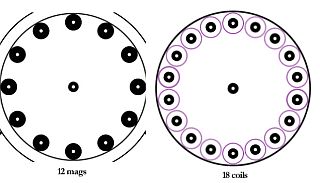

Hi - long time lurker - first time thread.
I'm looking for input on my single rotor/dual stator design.
Something similar to this thread: http://www.fieldlines.com/story/2006/9/9/175715/7026
Most discussion on this board relates to axial flux/air core design.  I've read a few threads discussing the single rotor design - it seems most recommend against it.
However, my design is for low RPM/high torque and the most important parameter is to
generate as much power as possible with each RPM: cogging, eddy currents, heating etc. are less important an issue.
As such - it seems apparent to me that coil cores are needed, grain-oriented silicon(electrical) steel laminations being the superior material.
The single rotor/dual stator idea is to capture the field from both sides of the magnet into the dual stator coils.  It seems this logic is flawed when considering an aircore design - but I'm of the notion that it is a practical design for a device using cored coils.
The design is 3 phase and uses the mag/coil formula of:
# mags/2 x 3 = # of coils. example: (12 mags/2)x3= 18 coils
This is diffent than the 12/9 axial flux design - but is accepted given the proper geometry:

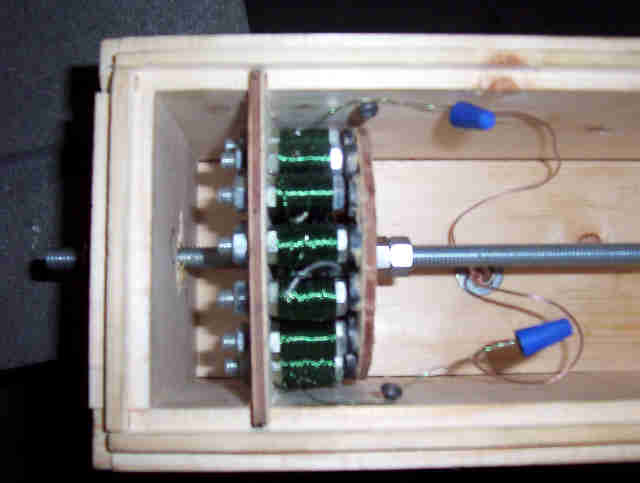

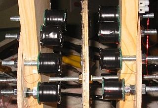

The protype:
Small protype design
An 8" inch rotor / 12 mags .75" x .75" N42
With 18 coils each side, 3 phase star (6 each phase) : each side then connected parallel.
Coils: #30 AWG / 1"width x 1"long / 30 ohms
Core: 5/16" grade 2 hex bolt (for now - same size electrical steel laminations later)
Airgap (each side): 1/4"
RPMs: 60
The small wire is so-as to maximize turns to boost voltage.
What can be done to improve this design?
Or am I way off base?
1. The coils are receiving large flux.  A paper clip will stick to the back of the core.
Should the backs of the cores be linked with iron? (like a cross-bar between each)
Or should it be a full circle of laminations?  Or none of the above or something else?
  1. Should I wind the coils with 2 or 3 in-hand to drop the ohms and use a voltage-boost circuit if needed?
  2. An approaching N magnet is 5% over the coil while the receding S magnet is 5% over the coil.  Does the geometry need to be tweaked to improve the "leg" time?
  3. The coils/magnets are round.  Should the coils be wound more oval to increase the legs and decrease the "heads/tails" or does the iron core overcome this?
  4. The core width is 5/16" with the overall coil at 1" (11/16" windings) while the magnet is .75".  Is the "small" hole ok because of the iron core?
  5. Each coil has it's own core - or should it be designed more like a traditional alternator with slots/teeth etc?
  6. Wood/plywood for now.  Thinking polyproplny (butcher block plastic?) for later.
The rotor should be non-magnetic right - to prevent "sucking" up the flux I want going towards the coils?
Thanks for reading and I look foward to any/all replies, suggestions, ideas and links.

I'll take first crack at it.
It seems you are aware of what makes a PMA work, but choose to ignore the pitfalls.
The link you provided tells most of the problems.
Wrap count.  300'?  Is that 300 turns or 300'?
The 30 ohm part is a killer.
The magnetic circuit is not closed.
That is mostly why only 2V.
I can not even guess how you arrived at 2V and 0.5A with 30 ohms per coil.
Cores cause their own problems.
If you like the idea of cores, maybe try an induction motor conversion.
"small wire" makes for high voltage.  And low output.
The high voltage is not there because the magnetic circuit isn't closed, and eddys in the bolts, and the airgap issues.
Voltage boosters slow the bleeding.  They do not heal the wound.
Designing something with the intention of needing a voltage boosting circuit is like cutting off fingers now so they won't get hurt later in table saw accidents.
The device would work a lot better if the distance from the coils to magnets was shortened (a LOT).  Normally I would call it the air gap, but the magnetic circuit is not closed, therefore the airgap is somewhere in the triangle between undefined, leakage, and infinite.
And maybe if the bolts were put in steel plates... It would close the magnetic circuit.  Eddy currents and their related heating and cogging may move up on the list of "less important" issues.
It is not an odd idea.  It is a flawed idea many new people have.
I know a guy who made this a long time ago, and he wouldn't bother making another.

ghurd-
Thanks for the reply!
"Wrap count.  300'?  Is that 300 turns or 300'?"
Thats 300' - about 2200 turns each coil
"I can not even guess how you arrived at 2V and 0.5A with 30 ohms per coil."
oops typo- that's 2V @ .05A with 40ohm coil (wrong coil ohms)
(yes - small - but the protype is only 8" rotor - real build would be MUCH larger)
I have also implemented a 1:4 vbelt pulley setup in one build - increase RPMs and output (at the cost of 5-10% as a pulley setup is close to 90-95% efficeint?)
The voltage-multiplier was just a thought if needed to further boost voltage after winding several strands in-hand to reduce resistance.  Is this defeating the purpose and I should just go with a bigger wire in the 1st place>
The pic you linked to is just like what I'm thinking - but with magnets and coils on both sides. (is there a thread discussing this build?)
The pics I posted are sloppy in that the airgap is not set - it is 1/4" - more like the pic you posted.
"And maybe if the bolts were put in steel plates... It would close the magnetic circuit.  Eddy currents and their related heating and cogging may move up on the list of "less important" issues."
Would putting "cross-bars" at the back of the cores to close the circuit offer the same idea but lessen the eddy currents etc.?
Or a "ring" of lamnates?
Will a core design offer relative output improvements?
ie: 10 horsepower input / core design = 50% increase in output but at the cost of 25% input due to iron losses.  Or when comparing the two designs - it is close enough to equal output that a design without cores is preferrable?
Thanks again for the reply!

Re: Single rotor dual stator design
« Reply #7 on: November 06, 2008, 04:02:08 PM »
"about 2200 turns each coil"  I freaked when my last new idea came up with 600 turns.  And the one before it was 1600 turns IIRC.
"typo- that's 2V @ .05A with 40ohm coil"  A free stepper motor beats that.
"The voltage-multiplier was just a thought" & "Is this defeating the purpose"  Cut off all your fingers you want, but if you started with 10, cutting off fingers will not get to 50.
"increase RPMs" in a situation like this is pointless due to the inductance of a 2200 turn coil.  The thing is going to peak out.
The entire design is hopelessly flawed.
"but with magnets and coils on both sides. (is there a thread discussing this build?)"
Yes.  Many.  Probably google search the board for "dual stator".
And maybe Monte350(?) had pertient files.
Laminates would help.  Some.  The airgap is still "huge".
Cross-bars would only help on paper.  What is 1/10,000th of 1/10th of 1%? kind of idea.
Core ideas are way past what you have presented so far.
The 2200 turn, 2V, 50ma, 40 ohm coil, sounds like a tiny stepper motor.
"Will a core design offer relative output improvements?"  Sure.
Just the same as my (newly discovered / no wonder I have issues) step-brother-in-law-in-law's semi will go farther with a gallon of diesel than my neighbors riding lawn mower...  After that 30 ton trailer is added to the mix.
You disregard the 30 ton trailer when it is not convienient for you, then include it on the 'bad' side to make your PMA seem better.
If the things that make it a poor PMA do not matter, then it is a Great PMA.
The actual output says otherwise, because the output includes everything.
The 8" thing makes it big enough.
I don't call it small until it's less than 4". I used to think 5" was small.
And yes, I have troubles too.
But it is easy to smoke those numbers with a 1.5" dia x 0.75" stepper motor.

capthook
  • Posts: 36
« Reply #8 on: November 07, 2008, 12:52:57 PM »

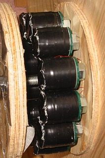

The dual-rotor design with the completed magnetic circuit seems the better design approach.  However - the relatively low mass of copper in the current designs I feel is not offering full potential output.  I'll mull that part over and post some ideas.
I already spent weeks on this presented (crappy i guess) design.  I wound 18 coils with 2200 each - took about 1 1/2 hours each to wind neat and tight.
Thanks for the comments and helping me shape my thinking. (and preventing me from wasting even more time and frustration conintinuing the same path)
« Last Edit: November 07, 2008, 12:52:57 PM by capthook »

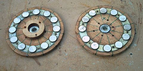

What about doing the rotors like this?  The idea would be to keep the rotor weight down.  Maybe 2 pieces of 1/8" steel sheet cut out in circles a bit wider than this pic shows and screwed together to make 1/4"?  Or 1/2"? Or will the gap between sheets reduce the effect?  Or will it be WAY less effective because the steel mass is not sufficient?
And as to copper mass.  What about increasing coil height? Like 2 in-hand, side by side - stacked ontop of each other?  Yes - all the windings might not receive a full 1.2T flux, but power output should increase?
tx

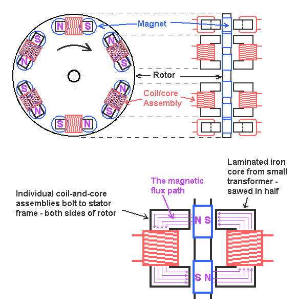

And as to single rotor designs:
This is the best idea I've seen yet - presented by Electric Ed:
There was little/no discussion of this design.
You have the benifit of a lamintated steel core, and a completed, strong magnetic circuit.  And all the windings are perpendicular to the flux path meaning no "dead" coppper.
It would seem the increased power output would greatly outway the iron losses.
Thoughts?
