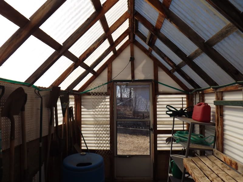

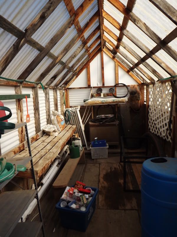

« Reply #54 on: April 13, 2012, 12:15:48 PM »
Well, it is a greenhouse thread...  ;D
Maybe this is the better place to ask, rather than starting my own thread... We just moved out of town, new house came with a 16' x 8' x 10' tall greenhouse. Love the theory, scared of power bill :) Wife and I both have plans, but we need to make it reasonable to operate...
2x4 construction, translucent corrugated fiberglass sheeting. Has 15amp service, and natural gas furnace (early 80s vintage?).
Now we'd like to get close to 4 seasons use out of it (now we are at 51' north - north east of calgary) - I'm most likely going to do some rework on it... Add a layer of 6mil poly to each side of the 2x4 framing (keeping the fiberglass too) to get some 'insulation' for what it's worth... Thinking about a 6' or so extension - basically a utility room to store all the gear I'm going to be adding (and get some of the aquaponic tanks out of the sun). Yes I will be replacing that screen door :)
While I'm in re-working, I'm thinking about installing: http://www.sunnyjohn.com/indexpages/shcs.htm . Using the 'standard' greenhouse calculators, looks like I'll need about 40,000btu of heating on the coldest days we typically get around here; trying to make heads or tails out of what I'll need for solar water heating to keep that CNG furnace off (albeit with all the solar water I've been contemplating; I might replace it with a more typical hydronic boiler scenario?) - we're probably going to tie in a hot-tub (wife wants one - and likes it HOT (as in 40-45C hot)- so perfect candidate to hold ~800g of toasty hot water) as a heatsink... I was thinking a paver floor, possibly with some PEX floor heating loops...
Still waiting on my hugh piggott book; been in customs for a month now... Obviously this customs agent who's reading it is a slow arse reader... But we're in a perfect spot for wind, Category 3 in the winter - basically still in summer though, no local restrictions, and we live close enough to trains, that we have no noise restrictions...
I'd love to hear some advice/suggestions on how to do this...

Hephaestus
  • Posts: 12
Re: Greenhouse anyone?
« Reply #56 on: April 13, 2012, 01:04:54 PM »
Yeah, I've already lost a few ... days (might be closer to weeks) between builditsolar and scoraigwind... :) And this place sure isn't helping either... :)
