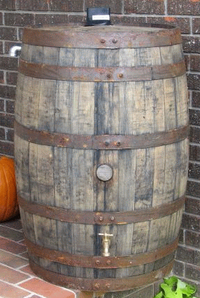

There are used whiskey barrels for sale. Empty of course. That would give your drinking water a special flavor.
http://www.kentuckybarrels.com/RainBarrels.html
I think the alcohol would sterilize them pretty well.
Re: Got some barrels (3.00 / 0) (#14)
by esc on Wed Dec 03, 2008 at 06:56:53 PM MST
Nice.  But at $170.00 each they are a little out side of my project budget, which is currently $0.00.

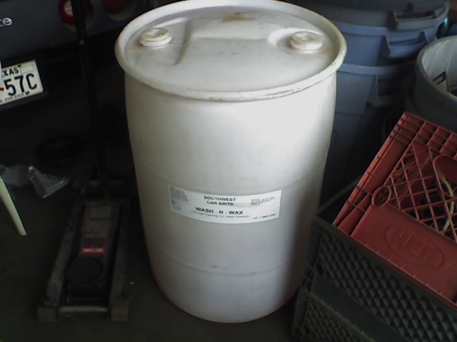

by esc on Wed Dec 03, 2008 at 06:49:25 PM MST
These are single use barrels and they are clearly labeled as too contents.  Like I said, I'm going to take the labels to my local Toxicologist and ask him.  They also have stickers which rate their biological hazard (of the soap barrels) as a 0.  But they do recommend you flush your eyes if you get soap in them.

by esc on Wed Dec 03, 2008 at 06:43:04 PM MST
If I do use any of them for drinking water an additional filtration system (filter + activated carbon + UV light)  (and maybe reverse osmosis too) would be used.
I'm still thinking that the white ones, with soap in them could be used for drinking water.  But I'm not going to do anything rash.
Even if I don't use them for drinking, I could still use the water they hold for lots of other things.  Even when I was hooked up to the local water company, I would never drink their water anyway.  More often than not they had a "boil first" order in place.  So it won't be much different even if my water is stored in a bunch of toxic barrels.  ;)
