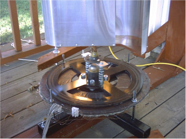

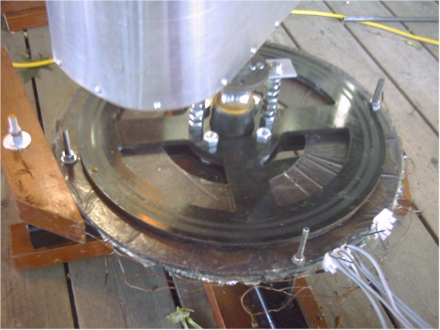

I built a 15.25" diameter alt. with 18 coils - 18 AWG, 70 turns ea. with 24 neo mags 1" x 1/8" round on each rotor. The rotors I had made at a local machine shop for about $75 total. They are made out of 3/8" steel plate. I had 4 cutouts put in each one to cut down the weight a bit. The rotors ride on a 4 bolt trailer hub/axle, which is welded to an X-shaped frame made out of 2" box tube, 1/4" wall.
I wound the coils using the usual sort of former - 2 pieces of 3/8" plywood, but I used a 1/4" dowel in each of the 4 corners of the coils, with a spacer in between of about 1/4" thickness. I cast the rotor with 2 layers of fibreglass cloth on both sides for strength. The overall thickness of the rotor is 3/8". The airgap on each side between the stator and magnets is a little under 1 mm (sorry about the mixed units!).

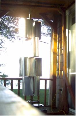

The first place this alt. ended up was on the bottom of a Savonius rotor assembly:
One day last week when the wind was at around 16 mph, this thing was turning at 125 RPM. The load was one 25 watt light bulb on each phase (48 ohms ea.) I measured the voltage on one of the phases by taking out the light bulb. The Fluke reported a peak of 34.5 VAC/50hz.

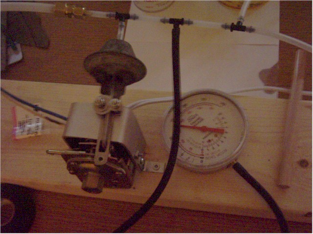

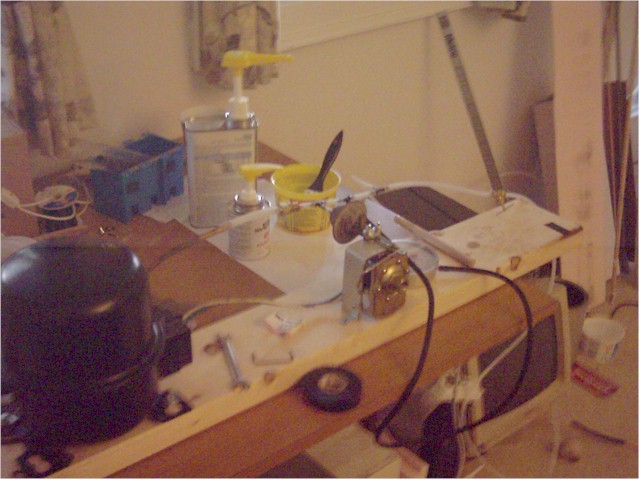

I cut out some NACA0015 profiles using a home-made hot wire setup, and profiles from the excellent X-Foil program which you can download for free at http://raphael.mit.edu/xfoil/  With a little prodding the program will create a ps file, which can be opened in Acrobat, then scaled as desired. It's pretty easy to make a vacuum bagging setup:
That's an old frig compressor - and the switch is from a water pressure pump - with a vacuum advance unit from a GM HEI distributor pulling on it...

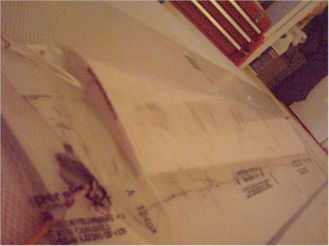

Here's a pic of the first wing in the vac bag:
I'm aiming for 200 RPM or so with this test setup. It will be mounted to horizontal struts on the same frame where the Savonius now resides. About those wings - they do have to be strong, and light, due to centrifugal forces. At 200 RPM, and a 54" diameter on this test unit, the force involved will be about 30G! So if the wing weighs in at 2 lb. it will weigh 60 lb at speed. There's a nice mechanical brake on the top rotor with a long piece of rope attached if things don't work out!

The unloaded blades will start to rotate in about 7 mph worth of breeze. The alternator hits 12 volts AC at 40 RPM. The fastest I have seen this particular unit spin was at 125 RPM in a really stiff breeze of 16-20 MPH. The output at that point was around 35 volts AC. That day it had a load of one 25 watt/120 volt bulb on each phase. To measure the voltage I unscrewed one of the bulbs - this was at night, and I would say the bulbs were at about 1/3 to 1/2 their rated brightness. If it was more highly loaded, of course it would slow down. The blades are 18" wide and the stack of 4 is 56" high. For the next couple of days I'll be continuing to work on the foam core Darrieus blades. I'll mount them, probably removing a few of the Savonius sections and see what happens!

The experiments I have been working on with vac bagging foam core wings look very promising. The first one out of the bag is a NACA0015 with a 7" chord - 5' long. Last night I placed it on 2 chair backs and put a box of books in the middle that weighs about 60 lb. There was no deflection at all. These things are really strong, and very light. Boy am I long winded!
