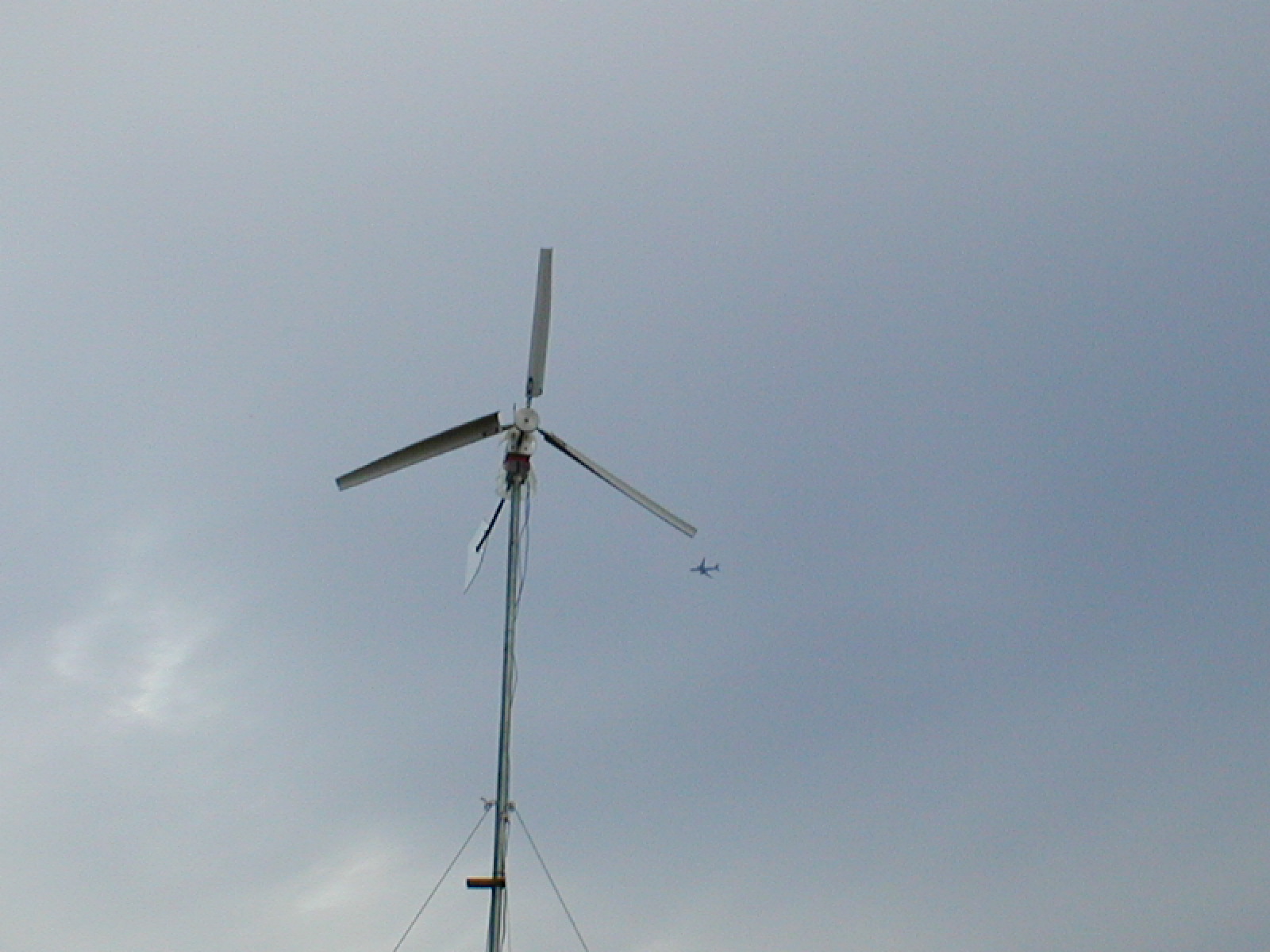

After two months of fighting blade design flaws, my wife finally figured it out.  Not wanting to carve blades, I tried several designs of my own making and nothing seemed to give my new windmill project just what it needed for rotation.  My first two blade prop shattered when the tower came down in a storm (learned alot about tower design from that one).  My second was a three blade hub I made and attached several versions of flat, straight blades which could be adjusted for pitch at the hub.  This started up great but had very low RPM.  Finally, my wife ( who had up until now been my biggest obstacle in getting my windmill up in the air) described what she thought would be the ideal blade with some sort of concave faces.  I gave it some thought and decided that I couldn't make it so it wasn't feasible so I promptly shrugged her off.  Shortly after this, I came across Zubbly's pictures of his PVC blades and quickly made one from some scrap I had around.  My wife said "That's it!"  The initial tests were less than favorable but I could see that the concept was fine but the fabrication left something to be desired.  I finally took the scraps from the cutting of this test blade and attached them to my three blade hub I had previously made and had instant success.  Immediately got approx. 75 RPM with just a breath of breeze (approx. 5 knots) and saw it go upwards of 200 RPM with slightly stronger gusts.  For the time, effort, and expense involved, this is an excellent blade material and should be considered by anyone trying to start out.  The main moral of the story though is to listen to your wife once in a while.  If she has some stake in your "hobby" it makes life alot easier.  :)

That's really cool, now I'm wanting to make some PVC blades. LOL  Carving the wood blades was a real pita and took me a long time.  Btw, I noticed the way the blades were mounted that they would flatten out some(if they bend any from high wind) decreasing the angle on the blade.  I wonder if that some how slows it down like a furling system?  Seems to me you'd have to have the blades mounted on the other side to have it work like that, but these windmills are still quite strange to me in some ways.

It was Zubbly's pictures that I used to get started making these.  I don't know about him but I just kind of drew what looked right on the pipe before cutting and it seemed to work well.  I would like to see someone post some layout drawings to help folks get started in making the PVC blades.  If your interested in getting off easy, some guy is selling 3 and 4 blade rotors on ebay for around $40.  I don't remember the sizes but they appear to be made from 6" PVC pipe though he calls it "polyvinyl plastic".  It looks like a pretty sound design.  I didn't bother getting the auction number but if you go there and do a search for "windmill turbine" you will get several of his offerings.

hello Jim. very happy to see that the pvc blades worked out for you. you should coat the blades with aluminum paint to help prevent uv ray damage. i will be posting more on blades with instructions and diagrams. have fun
