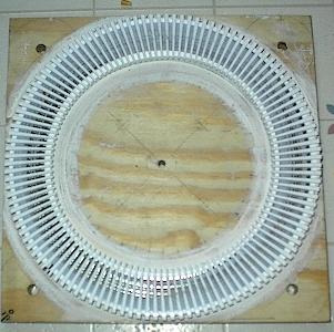

  If your coils are going to be thin it may be better to simply pour the plastic and either drill or machine the plastic on top of the steel core.  I think the iron powder will lower the efficiency. You could drill the steel for the coils similar to my original idea of drilling a plastic form for the dual rotor machine.  This works quite well although it takes a bit more time
  This is one of the cores from the 2500 watt machine I did last summer.  It has a plastic overlay on the silicon steel and the plastic was machined to hold the wires in place...
Have Fun! Windstuff Ed

by iFred (ifred2006@yahoo.com) on Tue Nov 11th, 2003 at 10:02:31 AM MST
Hi Jerry.
My stator core is a composite of 90% iron grindings and 10% fiberglass resin. Ed is correct, you would get much much more output from thin metal laminations then from a poured core form, however there is major fun that comes from putting together a pour core mold. The intial tests show that it is working well, and I beleive it could be enhenced further, which I am attempting to do. I beleive with embedding some  laminations into the pour code as well (esp; in the poles) the output could go much higher. I am presently working on a 13 inch disk with this idea as well.
Take a look at the wood form that I make on this page of my web site. I used wood dowels and a simple form.  http://www.internetfred.com/newgen/newgen.html
this produced the mold.
The idea for the poured core form came from Ed, I got it from him. He's a master at building things!! Amazing some of the stuff he comes up with.
My suggestions on to building one are, increase the width of the core and thus longer wire per pole. Longer and more magnets, thinner poles. larger slots for more wire.

iFred did you just pull the wood dowls out after the resin set or did you drill them out? What was the outside form in your mold. OH the inside to? I would think if you kept the slots narow were you slip the coil wire through, the cogging would not be to bad?
Did you wind the coils first and then drop them in place or did you wind in place around each pole or did you do wave winding? I think thats 3 ?

by iFred (ifred2006@yahoo.com) on Tue Nov 11th, 2003 at 11:22:22 PM MST
Hi Jerry
Glad I can help and anwser your questions.
The bottom of the form is plywood, to this I glued a paper template that was filled with guidelines 22.7 deg apart. to the outside of the mold I cut some sheet metal (duct metal) and wrapped it around wood base and used some wood screws to hold everything in place. (i used some duct tape in the bottom to prevent spillage. The center was also made of wood. I then gave this part of the mold a coat of varnish.
When I finished the build, I cut the dowels to a single length, then I sanded them (ends) individually to fit for each position. I did this 32 times, once for each dowel. I then marked each position on the dowels, just in case. I then greased everything down very well including each dowel individually. Everything was a tight fit, it's critical to get a tight fit.
I measured everything and mixed the iron grindings and resins together, had to work quickly.. ...(resin went around and under the dowels when packed in slightly, but not enough to jar the dowels(the tight fit-:)). Also: To prevent bubbles and stuff I continually shook, rotated and gently slapped down the mold to make sure the stuff got into all areas of the mold. and continued to pack as much as possible up to the top of the third layer of the mold. The third layer tells where to end.
When completed the dowels popped out with very little problems, only one gave me an problem and I had to drill it out. But all in all the dowels came out smooth. Next I used my dermal to cut out the centers in the top between the poles. The slots where narrow to allow the wire to go through and just a little extra. Dermal with a cutting blade works great on this material!
The cogging is minimal. I used a metal plate made of multi sheets (not suggested) of sheet metal (in order to get thickness). I am still experimenting but I have 32 mags x 3 for width. YUP! you read correct.. 3 magnets per pole in lenght! 96 small mags 1/2 x 1/8 each.. Got a ton of them, don't ask ;-)
I wound each wire around each poel by hand, 25 times per pole. Man my fingers where killing me, I was shaking after doing 15 poles! LOL... Oh and... they where tightly wound and pressed into each pole with a peice of small hardwood I carved so i could fit in the most wire as I was winding each pole. It's very tighly wound ;->
