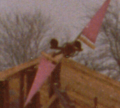

My first try at pics. I found these 30 year old pics of my first mill. 10 foot sailwing (ya, the funny looking pink things. the only cloth on hand) mounted on an old briggs & stratin engine block with 6-1 gear reduction from retired rotortiller with rotor mounted on output side to get 6-1 gearing increase. It was theh belt coupled to a car alternator. had a spring loaded "paddel" switch for the field controll. All it produced was enough to keep a light in the chicken house. It was so in-effifant that there was no chance of overcharging the battery except maybe in a hurricain. It was too far from the dome to run wires to, but fun never the less.
  A thin cable ran from a welded on bar about 10" long at the root of the blades to the tip, and the "sock" was sewn to fit. the wind bellowed it out to shape. the more wind, the more curved the shape and the more in-efficent it was.

  Previous pics were scanned from old photos where the mill just happen to very small in the overall view. I re-scanned at a higher (600)DPI.hope it isnt too big a file.
