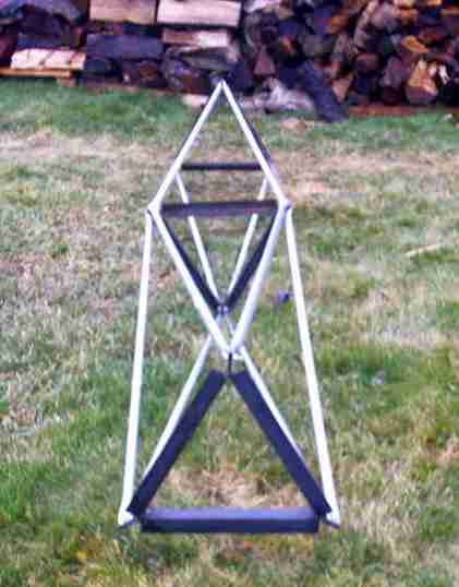

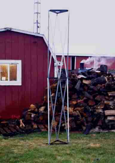

Have the first ten foot section done.
For a 30 foot guyed tower its  based on the Wind Works plans for a free standing  30 foot octahedron module tower.
That came out back in the 70s.
 Many thanks to Don G for tracking down and getting permission to reprint them they helped a lot.
 The vertical struts are 3/4 inch emt conduit and the horizontal triangles are 1 an ½ inch angle iron  1/8 inch thick.  The sides of the triangles are 1 and a1/2 foot.
I went with angle iron so I would have a flats to bolt the sections together.
I put together a press using a 2 ton bottle jack to flatted the ends of the conduit
When I get the next section built is where the fun starts
 I want to do some destructive testing .I know from my small models that these things can take one heck of a compression load.
I want to find out what kind of load it will take to buckle it in the middle with a force applied to the side should be fun.
I have no doubts that it will meet my goal. And that is to have a structure ridged enough to support its own weight and 200 pounds of machinery on top during raising or lowering.
Then the guy wires will handle the bulk of the wind load.
Here is an end view

Pipe towers are a low cost way to go .
But I want to get a way from having  to transport 20 foot section of pipe or do any welding in
the field if I want to go higher.
I have help raise some pipe towers for antennas and if you don't dot your I and cross your Ts thing can get hairy real fast . A pipe tower is 100% dependant on the guy for holding it up and during raising and lowering . A more ridged structure makes life a lot easer. And we are talking
more than just  compression loads.
That's why I am working with 10 foot sections that bolt together.   I can easily transport the materials in my short bed pick up. And the finished 10 foot section weighs in at 41 pounds.
As for cost the conduit cost 14 dollars the angle iron was 5 cents a pound at the scrap yard.
 Now that I am set up I can knock out a 30 or 40 tower'  in a weekend or at most two.
 As I work mostly by my self I want things I can easily handle. I not getting any younger : )
Old F

by DonG on Wed Dec 24th, 2003 at 03:34:15 PM MST
The original Windworks tower plans were built with one inch conduit and a maximum length of 10 ft for a section. You've shortened the modules so you can use the lighter 3/4" conduit and retain the strength. It should be just as strong. The strongest vector is a triangle and these are just a bunch of triangles. I'm curious what your destructive testing will find and how it matches the engineering data shown on the plans for downforce and sideforce. I'm going to add an email address to the classified ad in case anyone else is interested. I stopped running the ad in Ebay. It would probably be cheaper for someone in SD to just get an old water windmill tower from NE. They're everywhere in that state. The single legged pipe towers have very little strength when your raising or lowering the tower compared to an octahedron module. I've also heard some people complain of tower vibration too. A guyed 1" conduit octahedron module will cost about $35.00 for each 10 ft module figuring about five $7.00 ten foot conduit sticks. A ten ft piece 3" pipe will cost you about the same and not be as strong and have no entertainment value. I'm currently restoring an old wind generator out of the 1940s and should have it on top of a 52' free standing octahedron tower at my new house this spring.
