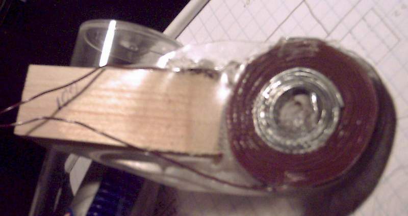

I read bill541's post about ferrous cores and that got me thinking... Since I don't have a lathe, but I do have a few B&S motors lying around I developed a twin rotor alternator to use for testing. It's small - only 7" in diameter.
It has 8 magnets total. 4 on each rotor. The magnets are also small - 1" x .125" disks. (Neo) I guess that makes this thing a 4 pole machine. The gap between the faces of the magnets is .405".
Here's what I tried so far:
First I wound up a sort of "standard" wedge shaped air core coil with 100 turns. The hole in the center is just a shade over 1".
Then I wound up another coil with a ferrous core. This one is round, also 100 turns. I started out by using some .030 body metal. I put a piece of masking tape down one side (for insulation), and cut a strip .375" wide and about 15" long. I coiled that up so it has an outer diameter of a shade over 1". The ID is about .375".
It was pretty easy to make, since I just shoved the coiled steel in between the cheeks of my coil winder and wound right on top of it. After winding I slathered it with epoxy, and attached a stick to it for mounting. I folded some 6 mil poly over it so it wouldn't stick, clamped it between my bench and a 2 x 4 to make sure it didn't grow any. Here's a blurry pic of it:
Here's the test results (sorry about the high rpm - like I said no lathe!!):
Both coils are .375" thick and there's a gap of .015" on each side of the coil to the magnet.
Air core coil:
RPM 1,800, Hz 60, Volts 4.8
RPM 2,100, Hz 70, Volts 5.7
RPM 2,400, Hz 80, Volts 6.5
RPM 2,700, Hz 90, Volts 7.3
RPM 3,000, Hz 100, Volts 8.1
Ferrous core coil:
RPM 1,800, Hz 60, Volts 8.7
RPM 2,100, Hz 70, Volts 10.2
RPM 2,400, Hz 80, Volts 11.6
RPM 2,700, Hz 90, Volts 13.0
RPM 3,000, Hz 100, Volts 14.2
Looks like the ferrous core thing is interesting. All tests performed while loaded with a 25 watt, 12 volt light bulb.
Next up I am going to try putting some laminates right in with the windings, sort of like: ({({({o})})})
For example, wind 30 wraps, and put in one "(" and one ")" on either side of the circle like brackets. Then wind another 30, and put in more steel. I figure if they're distributed a bit like this then there won't be much cogging.
I'll post the results of that test if I get up early enough to do it tomorrow. And if I don't run out of aspirin!!

Happy new year to you and all. Couple of questions How did you decide how much metal to use did you consider placing the layers of metal between windings of mag wire Will you try to see if it is scaleable in other words less copper same amount of production. This could be a good weight reducer, money saver, space reducer..... Great job I am hoping to start my coil testing but am stilling trying to locate a backing plate for my mags (needs to be cut special) My first design was going to be the metal copper metal idea.

I'm glad somebody else is interested in this too. If more than one person can get positive results, then there may be something to this. I like your idea of the spiral lamanents, that is a good way to make a round form out of flat stock. I think the silicon steel mostly comes in the form of flat stock.
It looks like the inside diameter of your coils are the same as the outside diameter of your magnets. I wonder if the diameter differences could account for the differences in gain between your setup and mine?
In the tests I'm running, the finished coil diameters are the same as the magnet diameters. I also found by having a metal disk on the ends of the coils helped as well (the spool shape). The disks I used were just mild steel washers and I swagged them to the ends of the center tube. Basically flairing the ends of the tubing to hold the washers in place.
I'm wondering if you placed metal discs on the ends of the coil you have if there would be any change in output.
Keep us posted on your tests!

Ted, Those results are impressive and after some research I think I am starting to understand it a little better. I found out that permeability is the resistance to magnet flux (U). Higher numbers are good and conduct more flux. Air, wood, and plastic are approx = 1, iron = 5000, and silicon steel 40,000. If the magnetic circuit can be approximated or crudely represented by a simple circuit v=I*R where I is the flux than lowering the total resistance is a good thing. More flux should mean higher voltage. I have been considering a concept to bridge the air gaps in the circuit. If total R is the combined resistance of two air gaps and the conductor in the center we want to minimize it. If 3 resistors are in series then I believe we add the sum to compute total R. If any one of them is a large number the system resistance will be high and bring the flux across the system down. I just posted a picture in the MY PHOTO UPLOAD section that shows a magnetic brush concept. I have explained the picture in my last Magnetic Brush post. I have read your and Bill541 work and think it is well done. I would really like to get your perspective on this addition. Regards, Steve M

I like the brush concept - but what about trying to put the brushes on the magnets instead? Perhaps some kind of fine hardened steel wire like a brush.

Get a roll of soft-steel MIG welding wire or just plain 'ol mechanics wire from the hardware store. Wrap the mechanics wire right along with the copper wire as you make your winding. Start winding on a 3/8" dowel and work your way out. This integrates the ferrous material right into the coil and virtually zeros out the eddy-current losses.
Re: formatted re-post of more on ferrous cores... (none / 0) (#7)
by Electric Ed on Fri Jan 02, 2004 at 03:03:52 PM MST
Better do this with a coil that you don't value very highly. There will be voltage induced into the iron wire, and if the turns are not insulated from each other, short circuits will exist where adjacent turns come in contact.
Current will flow in these "shorted" coils, producing hot spots, similar to what happens in a motor winding that has partially shorted coils.

I would have to agree with Ed on this one. The steel wire will make an inductor, not unlike your copper wire does. This steel inductor will have voltage induced on it, so it must be insulated from itself just as the copper magnet wire is. If you could wind a full layer of the steel wire and bond it to itself so that it did not form and inductor, then I think you would get it to work. Otherwise it should be insulated steel wire. You may be able to wind the coil so that the copper insulated wire always keeps the steel wire separated, but you would need to put a layer of insulating material between each winding layer... Just my thoughts, Bill
