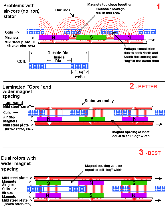

With regard to magnet spacing - - -
- - -My thoughts are similar to what Chuck said in his comment on DanB's post. I think a wider spacing might give better results for two reasons.
  1. less leakage flux between the magnets. Of course, dual rotor construction helps with this problem also.
  2. less voltage cancellation where the coil "leg" is over a N and S pole at the same time.
