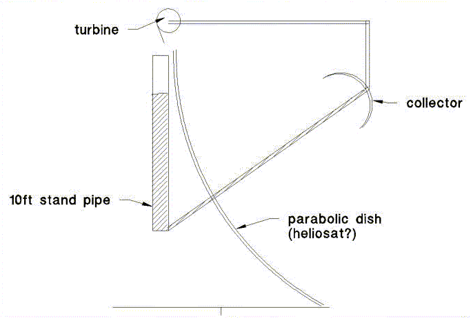

I've run across a large fiberglass satellite dish (free)and had some ideas for flash steam- the 10ft standpipe is to regulate the pressure (approx. 50psi--10ft water depth). I am hoping that someone on this list has some links in regards to sizing the colector and flash tube boiler section(pipe)(I have several sizes of copper pipe available to use). The turbine I'm still not sure about either- at only 50 psi a tesla type is out and I had thought about converting some auto a.i.r pump, but haven't diasassembled one yet.

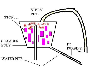

Re: Flash steam (3.00 / 1) (#14)
by hvirtane on Fri Jun 27, 2003 at 05:20:56 AM MST
The above is my
very rough picture
of a solar flash steam turbine.
I simply got enough
of drawing with a computer
and wanted to put the main idea first here.
I will make better pictures later.
DESCRIPTION:
Part A.
1. There is water in the container.
In the bottom of the container there is pressure,
because of the gravitation forces.
A water tube starts from the bottom of the container.
2. Sun rays hit the parabolic mirror 3.
The available power from the Sun is about one kW per
one square meter.
3. The parabolic mirror of 2 square meters reflects all
the sun rays hitting the mirror to the chamber 4.
The water from the tube goes inside the chamber.
4. The flash steam chamber is finned inside
with spiral fins so that the water coming in
is effectively suddenly heated.
There is needle valve letting the water in the chamber
from a small hole.
The chamber is made of ceramic at least outside,
so that it can be heated by the parabolic mirror
more than 1000 C hot.
The chamber is expanding inside towards the outlet end.
Inside the chamber flash steam is generated.
5. The flash steam coming out from the chamber hits
a crossflow turbine made of ceramic.
The crossflow turbine runs a generator.
Part B.
The parabolic mirror is arranged to be turning round
on an axle, which is on the same angle
as the axle of the earth.
There is a clockwork to move the mirror
so that it all the time focuses in the chamber.
DISCUSSION:
  1. The main power is coming from the Sun.
  2. Water gravity is used to jet the water inside the flash steam chamber.
  3. No big and complex boilers are needed for this kind of steam turbine.
  4. This solar flash steam turbine is simple to build even in rural workshops,
if ceramic craftsmanship is known in the area and
somebody teaches the right shape
of the mirror (parabolic),
which can be made of cement using small mirror
pieces as reflectors.
Reflectors can be made quite easily by pressing
machinery from steel as well:
5) The electric energy available
out of the process?
a) As told above, there is about
one kW heat energy available for
one square meter from the sun.
It is quite safe to assume that we can arrange
more than
50% of the sun rays' heat energy
to be absorbed as heat energy in the chamber body.
b) All that heat can be transferred into the flash steam
heat and kinetic energy, because the energy cannot escape other way?
c) A simple crossflow turbine generator can be made
maybe 20% effective.
So if our mirror is
2 square meters,
we might expect
200 watts from the turbine?

Re: Flash steam pictures (2.00 / 1) (#21)
by hvirtane on Sat Jun 28, 2003 at 03:47:35 PM MST
I changed the original
hand drawn picture for a computer made
rough picture.
The original 'hand made picture' is still
among my picture uploads.
How to draw this simple picture easily with
my computer I learnt from JCP.

Re: Flash steam (4.00 / 1) (#23)
by troy on Mon Jun 30, 2003 at 03:08:51 PM MST
Any dish mirror that brings the suns rays to a single point focus must be tracked in two axes very precisely, just like a telescope, which, come to think of it, uses a parabolic dish mirror.
The parabolic trough only needs vertical tracking, as the focal "point" is a long tube, so it doesn't matter where on the receiver tube the sun hits, so that lets you out of dual axis tracking.
Best regards,
troy

In my idea the water would come injected
inside of a really hot
chamber (about 1000 degree),
where it instantly becomes steam, which
goes into the turbine.
I got the idea to use ceramic (or stone) inside Sauna.
You ever go to any Finnish Sauna?
In a sauna there is a container ('Kiuas')
with stones, which are made
hot by a fire or by electricity.
You pour water on the stones, and
steam is coming out.
(The air temperature inside sauna is normally
about 80 degrees Celsius.)
The stones are generally about as hot
as red hot iron.
Yes, I know about a problem with most metals
and 'red hot'.
Normally a barrier of hot steam between water
and metal stops steam formation if the metal is too hot.
This is the reason I suggested using
ceramic or stone chamber and
injecting the water inside.
Injecting the water with reasonable
pressure might solve that problem with metals. too.
Even if stones in a 'kiuas' are as hot as you
can ever get them,
it produces steam very effectively.
In an electric sauna kiuas
there are red hot electric resistors,
in between the stones.
It produces steam very effectively, you have no need
to inject the water in.
You just pour it on the stones.
The water makes many many movements
in between stone pieces, before it is all steam.
Many people probably got
all the necessary machinery to try it.
You might try with a quite big chamber
made of reasonable good steel,
put in stones or ceramic pieces
(for example broken wares from your
kitchen will do).
Lead a pressurized water pipe in with a small pipe
hole. Heat first the chamber outside red hot
for half an hour.
Make the chamber body shaped such a way
that the steam has a way
to escape from the other end
so that it produces a good flow
of steam.
You certainly can produce steam this way.
If it is cost effective, I don't know yet.
Here is a very rough picture of the concept
To refine the concept I think that the first thing to do is
to make an adjustable needle valve for the water injection.
Hannu Virtanen

Re: experiments? (2.00 / 1) (#27)
by Andrew on Fri Jul 04, 2003 at 01:16:18 PM MST
Thats Ingenious!
I was thinking on just that on how to solve the problem of water just "skating" off.
I think a mesh of ceramic coated wire inside the flash chamber would be effective. (like steel wool) The problem now will be how to conduct heat rather quickly from the outside edges to the inside ceramic. (I have no idea on the thermal conductivity of ceramic)
-Andrew
Re: experiments? (3.00 / 1) (#28)
by hvirtane on Sat Jul 05, 2003 at 05:07:28 AM MST
"I think a mesh of ceramic coated wire
(like steel wool)
the outside edges to the inside ceramic."
You are probably right.
It is a problem.
Your design is something similar
I've got in my mind.
We might make holes in some
stones, but iron bars inside,
weld the bars on the container body?
My design idea is coming directly from sauna kiuas.
With electric kiuas the hot iron resistors are there
in between the stones. They are conducting heat
to various places in the stones.
With a fire wood kiuas the fire is under the stónes,
the water is poured on the top. Some of it boils directly
on the top. Some of the water goes further deep
in between the stones. Finally all the water
becomes steam anyway.
It might be better to design the chamber such a way
that the water is injected on the top of the stones,
and the steam could go out from the top only?
We can make in the water heat and pressure
enough already in the in coming water so that
it comes inside the chamber as flash steam?
Some water maybe could escape from
the bottom of the chamber
as well,
because we can maybe design the turbine such a way
that it can accept both steam and water?
I'm thinking that we should just somehow transmit the
all the heat to the water coming in so that the
heat energy is there in the water and the steam
coming out to the turbine.
Then we could use the heat still coming out from
the turbine to power a heat pump to get the water back
to the water tower?
Re: experiments? (2.00 / 1) (#29)
by Andrew on Sat Jul 05, 2003 at 06:22:54 PM MST
I would think that you would get more pressure if you went with a long and skinny chamber. It wouldvaporize the water in the front, and would be superheated along the way out by the rocks in front of it. As the pressure would increase, you would need the longer chamber because it would be too cool for steam because water boils hotter and higher pressures. Regarding the heats transmission. I was thinking that instead of drilling one hole in the rocks, just drill many smaller holes in the rocks (as much as you can) and weave a small iron or steel wire (6 guage?) through it. You would get more uniform heating as there would be more surface area covered. -Andrew
Re: experiments? (4.00 / 1) (#30)
by hvirtane on Sun Jul 06, 2003 at 02:12:17 AM MST
I think that you are right.
a)
A long and skinny chamber is probably better.
b)
And we need enough surface to transmit the heat
from the chamber body to the stones.
It is a matter of experimenting concerning the
right dimensions.
And it might work quite well, if we just make
quite many bars inside the chamber, welded inside
the container, but not fixed on the stones?
Because electric sauna kiuas works this way.
I'm trying to keep the pressure quite low and to
use as low level technology as possible so that
we could beat PV cells in price and power.

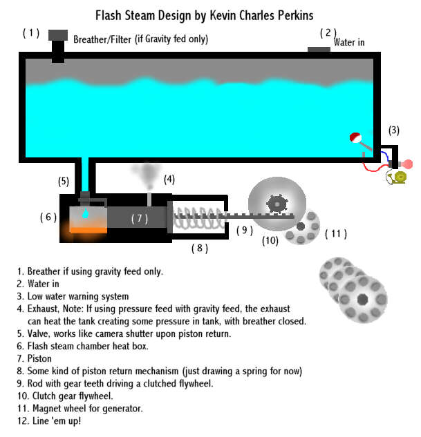

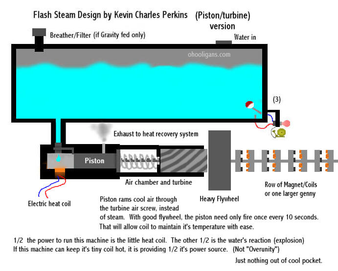

Re: Flash steam (2.00 / 1) (#11)
by Johnny Cool Pants on Fri Jun 27, 2003 at 01:33:16 AM MST
Okay, here is my "Turbine" version only I'm using a piston AND a turbine in this design, the piston ramming forced air through the turbine instead of steam.
JCP
