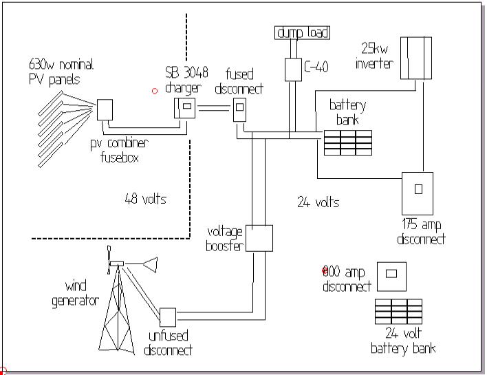

Having recently aquired a second set of batteries, identical to my first set, I'm now a bit confused as to what to do with them. My wiring setup is shown roughly in the diagram below.
The question would be, what would be the best use of resources in integrating this battery into the system? I should point out that the sb3048 cuts off pv when the batteries are charged. I'd like to recover that lost power into a dump load at some point. Currently, the dump load only covers the small wind generator (around 400 watts or so). I also expect to put up a wind genny that puts out 1 or more kw, so more dump loads at that point.
The easy thing would be to put it in parallel with the other battery. I'm not sure that's the best solution. Anyone have any ideas that might be better than that ? The end result will be supplying all our house and shop electricity.

use a C60 as a load diversion to the new bank

     I think putting it in parallel is the best thing to do. I don't like having new batteries in parallel with older ones without isolation. The C60 idea would isolate it, but it doesn't guarantee that the new bank will ever charge fully (not as the dump load). You want them charged full to avoid sulfation.
     If they aren't isolated, the bank with the highest voltage will waste some power trying to equalize voltages with the other bank. They might well see-saw & waste a lot of power alternately trying to charge each other up. If they are closely matched, this may not be a problem. Or it may not be any worse than an isolation diode would be.
      I'd set it up with a C60 to charge it in parallel with the other bank, but not as a dump load. Add another dump load, or rewire to feed more dump loads with both sources. If you are doubling the battery capacity, maybe you won't need a dump load, you can just use more power for something...........

Yes, these are the kinds of things that have been running through my mind. I may try several different configurations before I decide on a permanent one. I would like to isolate the two from each other, yet charge them from the same source(s) and discharge them to the same inverter.
