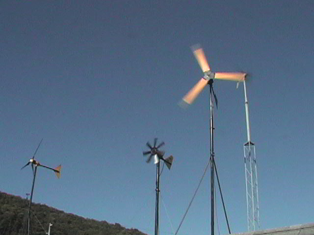

As someone who has put a lot of energy, time and money into rebuilding a few motors for low speed generator use, I have to pimp this little (40 lbs is little ?) motor a bit. This is the first DC motor I've seen that needs no modifications to be suitable as a direct drive wind generator. OK, it's not a huge output, and not comparable to the disk rotor brake alternators we all love to make, but for someone who is starting out and wants to get something up fast, spinning and making a few hundred watts I would highly recommend these little units.

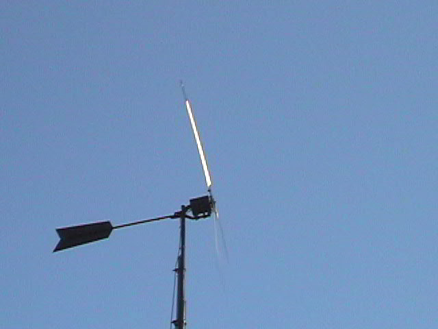

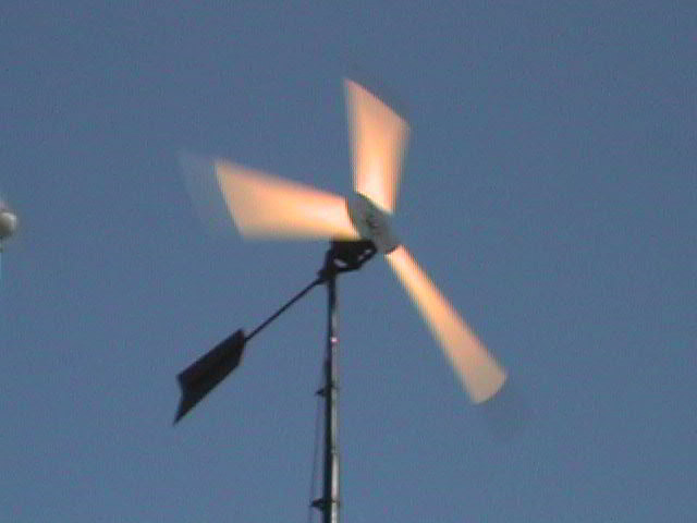

Hello everyone .... i just put one of those 40 Lb ..... 24 Volt ....194 rpm
up. New Brushes and Front + rear bearings. Sealed well .... we geta little rain
here in Wa. State. And all I have to say is ... Ya gotta love em. Have a 9 Foot diameter 3 Blade prop set-up. A little over 100 rpm to start chargeing ...sweet!Used some old WINCHARGER and Parris Dunn Parts for Frame . 5 Machines up .. Bring on Winter.
