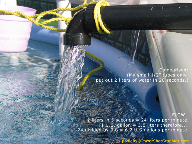

Well, I took the plunge last week and bought a single solar panel from a company to see what the difference was between my nice homemade system and a professional one.  Well, I'm impressed, and depressed.  I guess I am glad I'm impressed because the professional solar panel was expensive.  Anyway the thing puts out tons of water, and from what i have read, it's not just heat you need it's heat AND flow.  You can burn your finger with a match, but you can't heat a pool - meaning my little 1/2" tube homemade solar system is nice, but it's not going to do a great deal to heat an 18 foot above ground pool which is 5 feet high, - that's a LOT of water in there.
Once I got the professional system running today with the very large 1-1/2" tube, I quickly realized my that my system although cute was not anywhere near as strong as this one panel.
In any event, I am glad i tried using black hosing to heat my pool, and indeed it DOES work, no matter what any salesman will tell you, - you just need enough flow to get a pool warm.
I now want to buy another 4 panels from this company, - each kit or "panel" is 40 sq.feet, and with 5 panels, that makes 200 sq. feet, which should be enough to do my pool... - most places suggest 60% of your total area of pool.
In my case the pool is an 18foot, round above ground pool, so that's 256 sq. feet approx, so I'm well over the 60% needed to heat that pool quickly.

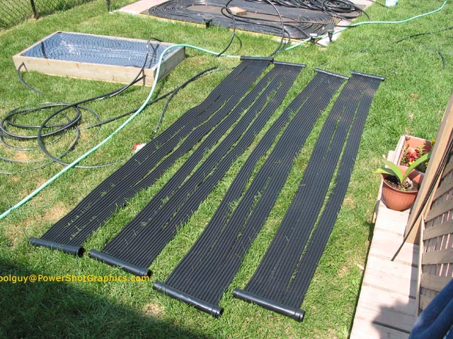

Anyway here are some images to check out.
Mark.

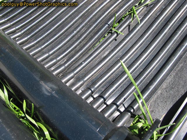

Does this mean my HOMEMADE solar system failed ? - by all means NO... and that's a very positive NO !, if I had the room - say I was living out in the country or had a lot of propery, I could use more black hosing and would have very good sucess with my homemade system.

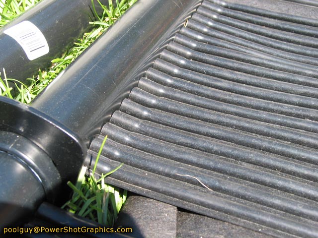

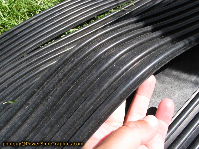

What you see in the images is ONE panel - eventhough you see 4 pieces, it is actually only one panel or "kit" ... which equals 40sq feet.
Install was easy, and I'm more than impressed.  Now to find somebody who doesn't scare easily and install this and other panels on my roof.... I have a 2 story house, and it's just impossible for me to even put my life on the line to put a solar panel system on the roof.

The professional panels are very effecient, that there's no need to recycle the water again into them, - they put out pretty hot water the first time, and the more panels the hotter the water.

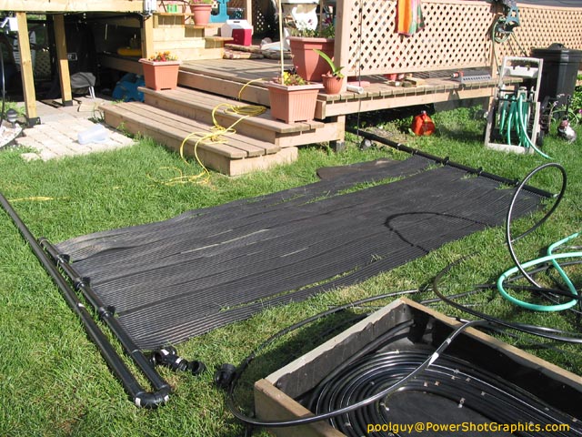

I wish I had that kind of problem.  Anyway I've just ordered another 2 panels this morning, and will hopefully get them this Thurday, and that will make a total of 3 for me.
I also found out that solar panels on a roof can cause major damage to your shingles, - because of shifting due to the constant movement of water in the panels and tubes.  I have therefore decided to build a structure on my lawn for my solar panels.  My home is only 4 years old, and the roof is under warranty for 15 years, -if I place the solar system on the roof, and in 5 years the shingles are worn through the company that did the job will NOT honor the warranty.  - Too much of a risk for me, so I'm keeping them on the ground.
I'll build a "deck" of sorts made out of pressure treated lumber, cover it with shingles, and then attached the solar panels on there.  Much cheaper than replacing a roof at $5,000.

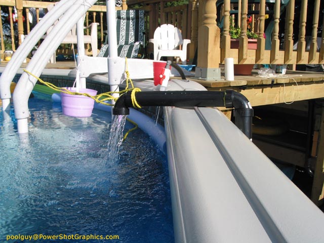

Here are some new pics I took of the solar panel.

Hi Demetri,
Nope, none needed, it just uses your existing pool pump, which is strong enough to power it.  3/4 to 1hp is what they ask for.  I have a 1.5 hp, so I have the valve that goes to the panel closed down about 80%, and still I am getting a big water flow.
