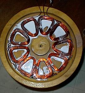

  Here is a drawing on the idea of making the stator on a dual rotor system thinner.  Basically a plastic disc with holes drilled into it for winding the coils.  This would spread out the coils making them much thinner to increase efficiency/power from the unit.  This would also help to keep the resistance down.  After it was wound you would have to make a mold for the mounting tangs and pour the plastic around the wires.  The drawing shows a 12 pole 36 slot disc.
  Continuous thoughts...  Have Fun... Ed

Hi ED
To make it easier to build how about a 1/4 inch thick plywood disk with 3/4 inch pine wedges
glued to it. Than after winding the coils you set it in a mold and cast resin over it.
This way you could get by with hand tools.
Just a thought.
Old F
Re: Dual rotor stator ... (none / 0) (#2)
by windstuffnow (elenz(at)windstuffnow(dot)com) on Thu Sep 18th, 2003 at 12:22:29 PM MST
   That would work.  You'd have to make a jig to crush the coils down when you were done to keep the thickness down.  The idea above is basically the same, you only need a drill and hack saw and probably a jig saw to cut the circle out. Also a protractor to lay it out. I think it would help contain the wires in the area the magnets are moving in.  You still have to deal with the thickness of the overlapped wires on the outer and inner part of the ring but the magnetic area would still be quite thin.
   I'm sure there is a better way... keep thinking.

Re: Dual rotor stator ... (none / 0) (#7)
by JB on Thu Sep 18th, 2003 at 08:46:40 PM MST
OK ED. You got me thinking now. I have some 9 1/4 by 3/4  round delrin discs. Now here are my ??. If you knew how you were going to wire this either star or delta could you wire or  actually be snaking the wire  3 slots next to one another and go over 4 slots and do the same, I think thats delta but im not sure and keep on goin without a bunch of splices so in the end you would end up with 6 wires and no splices instead of 24 wires and splices or would the wires from the other coils or other phase cancel things out as they would be going over the top of the others on the outside diameter. I was thinking of doing this  on my mill with a superspacer and making a groove in the inside and outside diameter to keep all the wires tidy. I hope you understand my ??.The hub and discs are not a problem. I finally got that part figured out.Im a little slow. Thanks JB
Re: Dual rotor stator ... (none / 0) (#9)
by windstuffnow (elenz(at)windstuffnow(dot)com) on Fri Sep 19th, 2003 at 08:20:42 AM MST
  Hi JB,  I'm not sure I understand what your trying to explain...  I usually wind them just like a single phase. But add two more phases in. So in the stator above you would have 12 poles, one coil for each of the poles make up one phase. So you'd start in one slot, skip two slots and finish the coil in the 4th slot.  So the first coil would have 2 empty slots between it when your done.  The second coil would be wound in the reverse direction as the first and so on until all 12 coils are in place. Second phase goes in the next open slot to the right wired the same as the first phase, and finally the remaining slots are filled with the same configuration.  You end up with 3 starts and 3 ends of which you can wire it for star or delta or set it up for both with a switch.
I'm not real good at explaining things... sometimes pictures are much better than words and I think some time back electric Ed posted a diagram of the same winding arrangement.  I'll see if I can find it...
Have Fun in any case..
Ed
Have Fun! Windstuff Ed

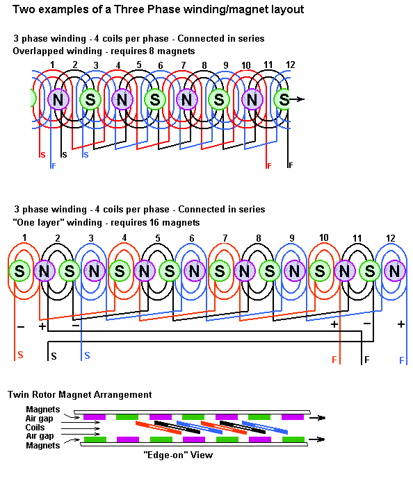

Re: Dual rotor stator ... (none / 0) (#11)
by Electric Ed on Fri Sep 19th, 2003 at 10:55:28 AM MST
Perhaps it was this sketch Ed was referring to.
Electric Ed
Re: Dual rotor stator ... (none / 0) (#13)
by windstuffnow (elenz(at)windstuffnow(dot)com) on Fri Sep 19th, 2003 at 11:26:42 AM MST
   Hi electric Ed,
      I think its the one but it seems like you had another one that was closer.  When I wind them each coil shares the same slot as the one before and after it.  Seems to compact the wire better.  I use 2 poles for 3 coils but the second set of 3 is partially covered by the first two magnets... I don't know if that came out right... I can see it but words don't seem to make the picture.  Basically 3 legs under each magnet.
Have Fun
Ed

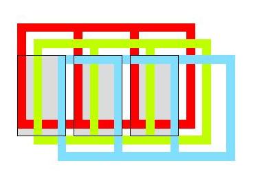

Re: Dual rotor stator ... (none / 0) (#14)
by windstuffnow (elenz(at)windstuffnow(dot)com) on Fri Sep 19th, 2003 at 12:45:54 PM MST
   I made an attempt to diagram the wiring I'm talking about...
In the diagram, Red is phase 1, green phase 2 and blue phase 3.  The grey represents the magnets.  Each coil shares a slot with the coil before and after.  This allows 6 legs positioned under each magnet or 6 coils are affected by each magnet.  This allows you to pack alot of copper in small areas and allows for less turns per coil to achieve the same output of other configurations.  This ultimately helps to lower resistance as well as cure other problems.
Have Fun!
Ed
Re: Dual rotor stator ... (none / 0) (#15)
by JB on Fri Sep 19th, 2003 at 03:43:55 PM MST
Ok Ed. I got ya covered now. Thank You. That word reverse in there through me for a loop but after about 6 times I figured it out. 36 slots that has to be.Got ya covered there also. Now my last ?? for a little bit. I got 1500 feet of 22 gauge neopreme covered door bell copper wire and  8 large neos. I realize that aint enough magnets for a non laminated dual rotor machine but im thinking that should be enough for a single rotor machine with 12 poles 3 phase.I hope im right on this. I guess I should by the book but my basic question is if I put a lot of turns of this 22 gauge would I get some good results or should I await till i get some money and buy the book and some 14  or 18 gauge. Thanks JB

Re: Dual rotor stator ... (none / 0) (#21)
by JB on Sat Sep 20th, 2003 at 01:00:53 PM MST
 Hello ED and others. Im thinking that my yesterdays thinking  and last post was messed up. If i space 24 slots evenly and 8 magnets evenly everything should line up to one of the 3 phases. Im thinking I dont have to cover 3 legs at the same time. just one phase at the same time.I wonder If Im thinking correctly now. Thanks JB
Re: Dual rotor stator ... (none / 0) (#22)
by windstuffnow (elenz(at)windstuffnow(dot)com) on Sat Sep 20th, 2003 at 01:23:15 PM MST
  Thats right JB... As long as everything is lined up it should work.  Its better to cover as much of the wire with magnets as possible but even if the magnet only covers one leg at a time it will work.  More magnetic surface means more power.
Lots of fun!
Ed
Re: Dual rotor stator ... (none / 0) (#23)
by JB on Sat Sep 20th, 2003 at 01:59:23 PM MST
Why Thank You Very Much Ed. I was getting a little Goofy thinking there. I was looking at the Dans triplets and then Electric Eds Diagrams and Your new stator Idea and getting foggy. Then I realized Electric Eds Diagrams are one for Dans type wiring scheme and One similar to Your wiring scheme which uses less magnets and more coils where Dans wiring uses more magnets and less coils. Thanks again. This is Very Nice of You. JB
Re: Dual rotor stator ... (none / 0) (#24)
by windstuffnow (elenz(at)windstuffnow(dot)com) on Sat Sep 20th, 2003 at 03:46:55 PM MST
  JB, you can download the instructions to my educational turbine to get an idea of how I do my windings ( as well as anyone else interested ). Maybe you already have... The little alternator uses 6 magnets and is a 3 phase system so there are 18 coils.
http://www.windstuffnow.com/3phasekit.pdf
It will give you a better representation of how I've been doing most of my alternators.  To make it much easier for beginners I wind one large coil for each phase and its twisted into the slots.  By doing it this way you end up with each coil reversed from the one before it.
If you have a large coil of 50 turns twist it and fold it in half you now have a coil of 100 turns, in half again you have 200 turns.  So my little turbine basically has 6 folds or the equivilant of 300 turns of wire per phase and a total of 900 turns of wire in a tiny space.

Re: Dual rotor stator ... (none / 0) (#27)
by JB on Sat Sep 20th, 2003 at 07:58:04 PM MST
Hello Ed. I  just figured out Acrobat reader and downloaded it and your diagrams. I  think i see what you are doin. I was going to do it wrong. I was going to fill up  slots one and four and then go to slots seven and 10 but wind them in the other direction fill them  and so on. The way you are doing it slot 4 will be completely filled when you are doing 4 and 7 and slot 7 will be filled when you are doin slot 7 and 10 and so on. Basically  the next slot 3 over will be filled halfway and filled all the way  when you are doin the next slot 3 over from it. I hope I explained this ok and that sounds right? Thank You. JB
