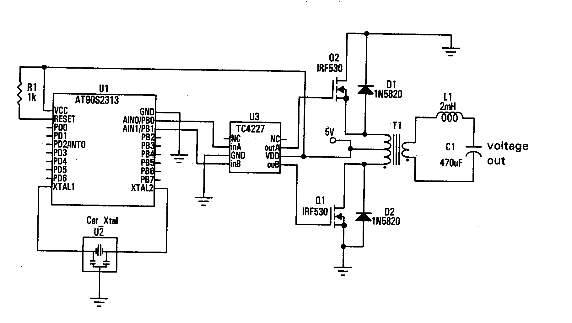

Sine inverter update
By RobD, Section Homebrewed Electricity
Posted on Tue Jan 13th, 2004 at 10:43:18 AM MST
Schematic
This is a rough circuit that I built to test the micro algorithm. It does not have, as yet, regulation and low and hi voltage shut off. The output wave is from the schematic shown and the algorithm is the one I outlined on the original post. I have not adjusted it for exact time or wave accuracy. Also the output filtering is just to see how the wave looks. You are welcome to the program. RobD

See "Sorry! try this" for the schematic and outputwave scope wave.
