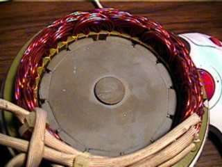

How many magnets does the 403 have?
How many magnets does the 403 have? I'm doing a design and to keep cogging down I'm using the same method as SouthWest. I remember pulling a 403 apart and figuring out the gaps and one odd long gap but I'm not sure if they left off one magnet and ran an odd number or just designed the armature with an even number and left room for one long space. RobD

There are 12 magnets. In the longer space is a bolt, holding the strap that goes around the magnets.
KenP
