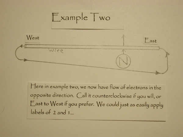

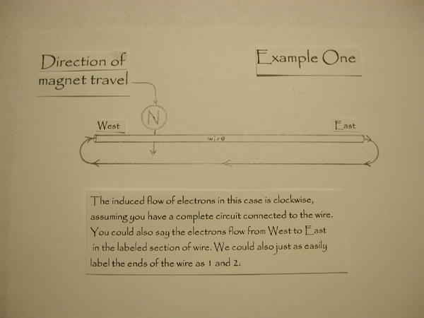

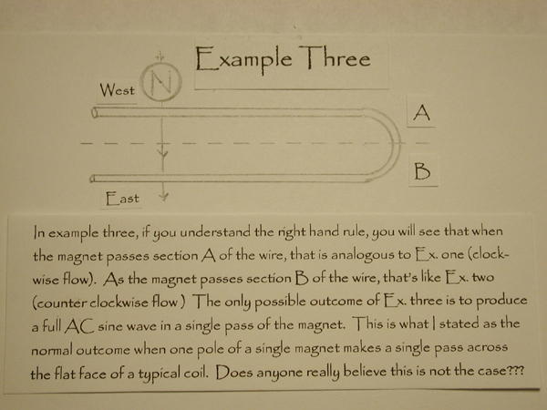

When building alternators, it is helpful, and sometimes essential, to understand the theory behind the machine.  Failure to understand the theory can lead to wasted time, effort, money and bucketfulls of frustration when the machine doesn't perform up to expectations.
Historically, there has been some confusion among some contributors here as to what exactly happens electrically when a magnet passes a coil, like in the many home built disk brake rotor alternators featured on this web site.  I asserted that one magnet passing one coil one time produces a full sine wave.  Others suggested that you would not get a full sine wave.  In an attempt to clear up some of the confusion, I offer a few fun diagrams and photos.  Comments are welcome, as well as constructive criticism if I have gone astray with any of the technical details.
So that more or less covers the theory. Feel free to review any basic physics book to drive that home.

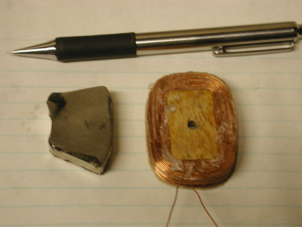

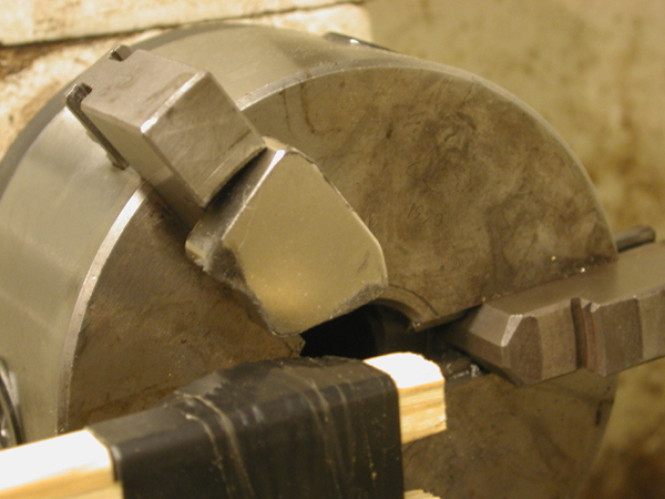

I took a magnet and a coil like so:
I stuck the single magnet to the chuck in my lathe and I taped the coil to a piece of plywood bolted down to the tool holder like so:

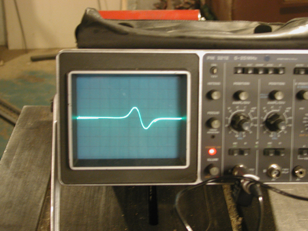

I turned the lathe on, hooked up an oscilloscope and got the following results:
As you can plainly see, the oscilloscope has captured and graphically displayed the electrical event associated with the magnet passing the coil one time.  Sure enough, a single beautiful full sine wave with both a positive component and a negative component.

Troy, I hate to be a spoilsport but that is not a sine wave.  A sine wave contains energy at only one frequency.  If you were to measure the spectrum of that transient waveform you would find that it contains energy at a range of frequencies.  In any case, nice work.  I'm glad to see some folks are using o'scopes to good effect.  What do you suppose would happen if the magnet was large compared to the coil?
How about changing the sweep speed to show two of the waves?
GeoM

Technically, you may be correct there.  Would you be satisfied if we described the wave form as sinusoidal, since all of the alternators we build fail to produce true faultless definitional sine waves to some degree or another.
But again, the purpose of the post was to refute the supposition that you would only get one hump, no electron flow in the other direction.  This clealy has an up (+) and a down (-).  In that limited sense, I think it looks pretty sine wavy to me.
