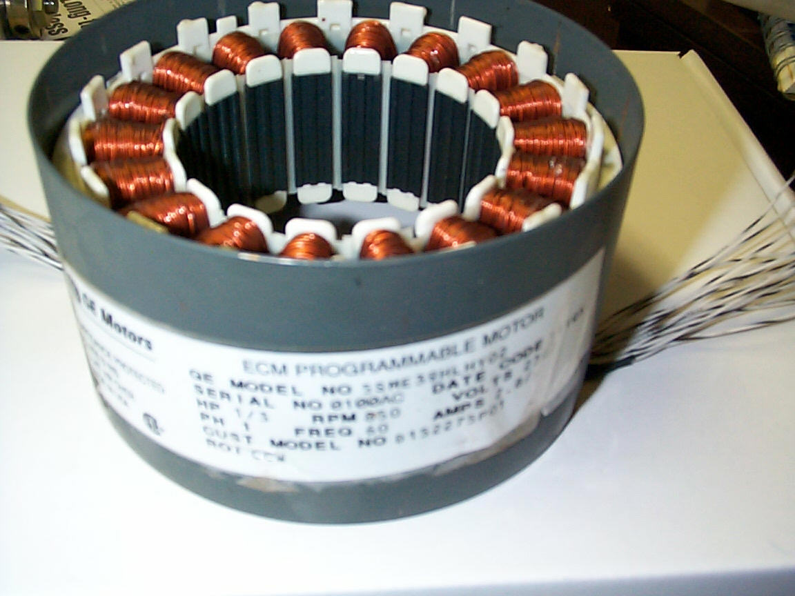

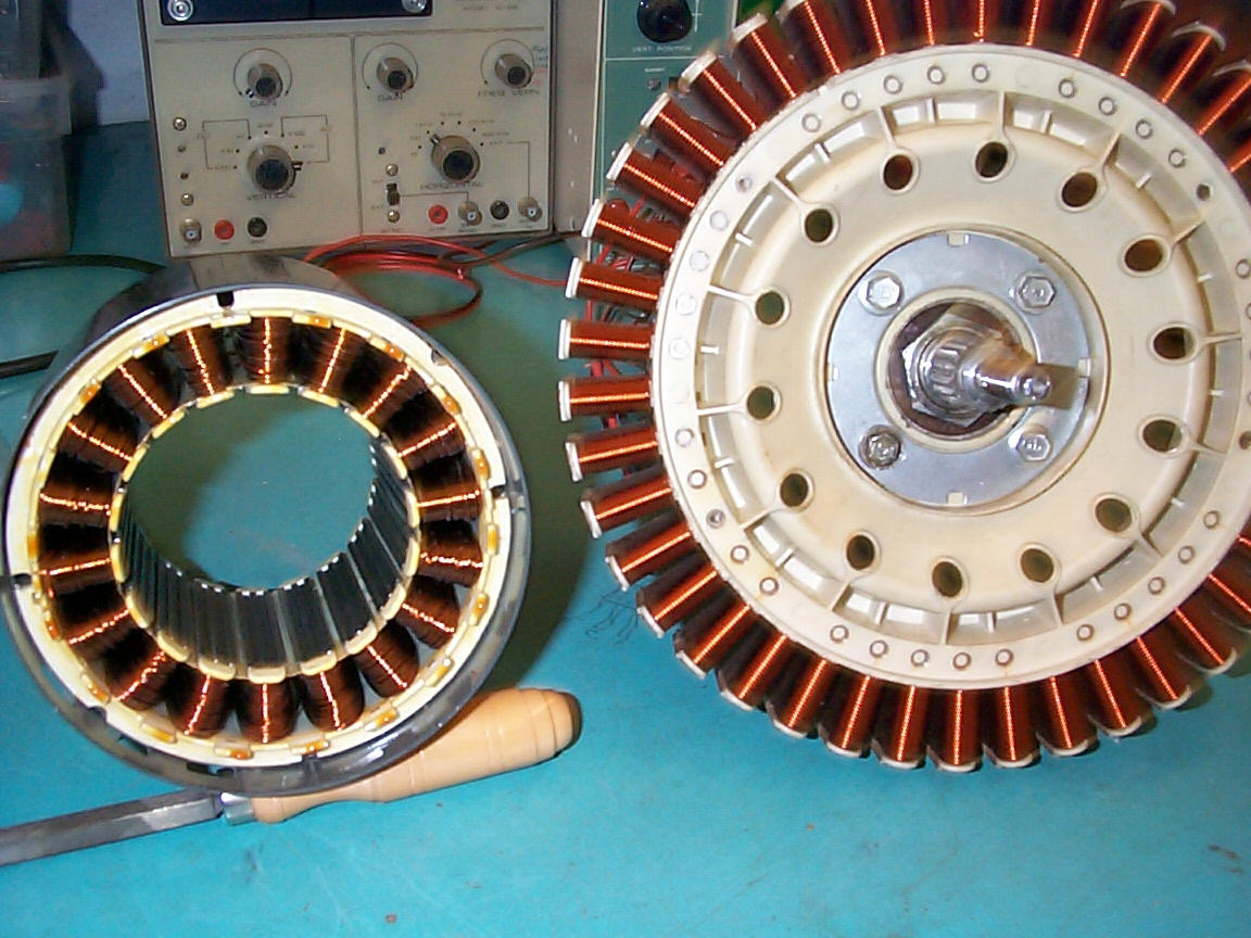

Here some pix. Not to good though.
Well I've tryed to load a pix of the GE ECM but its no working. It says its in my files but I can't select it to post and delites not working either. Must be an ADMIN problem?

by Jerry on Sat Oct 2nd, 2004 at 09:42:42 PM MST
No it was me. Goofy old guys and computers don't mix? This is a bad picture. The motor end plate has a 1" hole with 3 aprox. 16 ga. wires comming out.

by Jerry on Sat Oct 2nd, 2004 at 09:53:52 PM MST
I'm flying 3 of these at home curently. Using them for 24v. They do an easy 150 watts. I'm flying a couple at my store also.
One at the store has a fullwave bridge diode for each of the 18 coils. There all in perelell. Use this one for 6 volt charging.
I've a got a 2,850 lb hyster battery that was 36 volt. We changed it to 12 volt. I've made a center tap on this battery. This means 2 6 volt sides. Some of my gennys at the store are charging at 6 volt. This works good for my low wind area.
