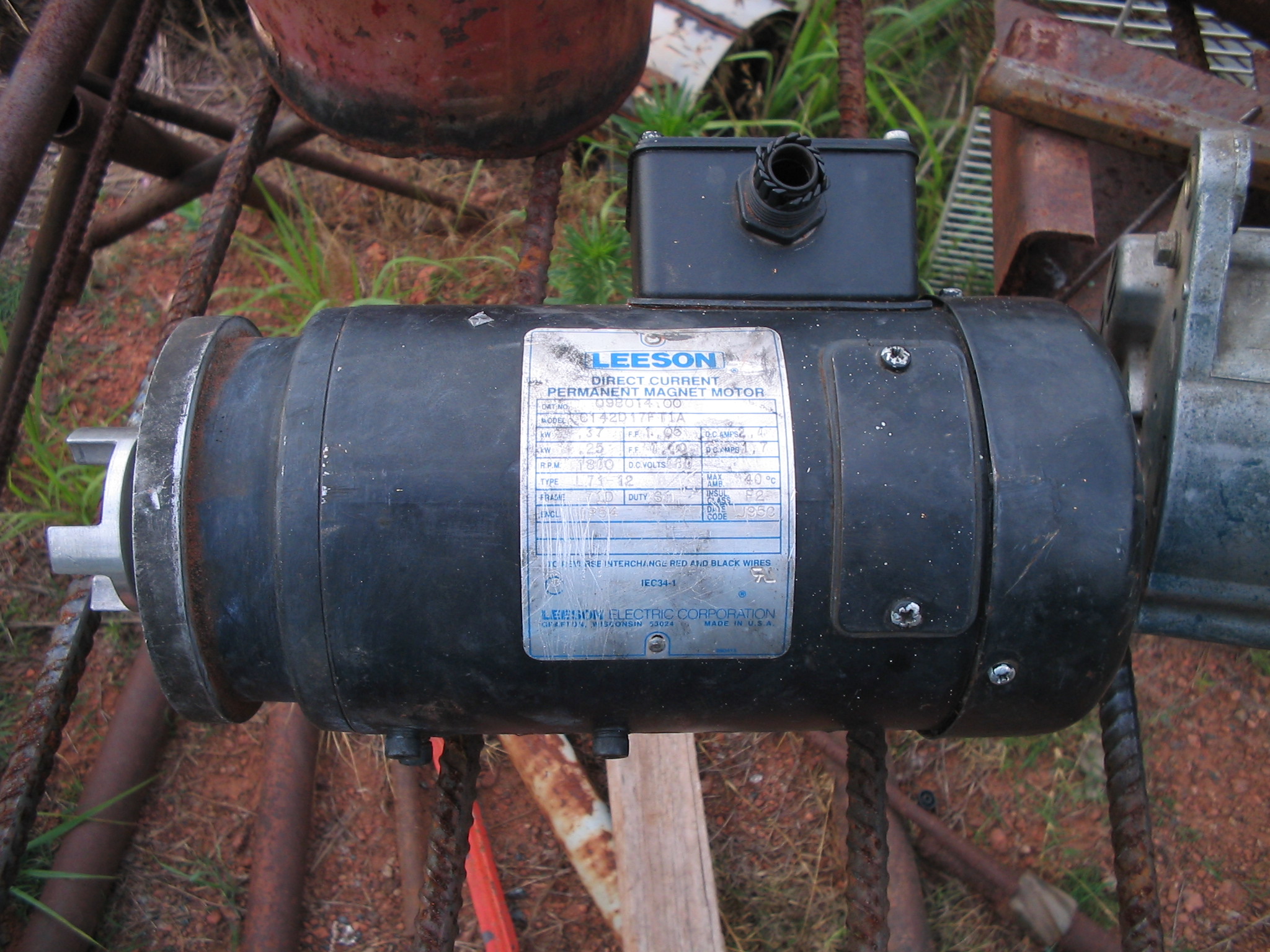

Here is an example of why the blades, wooden hub and blades must be securely attached to the generator. Last weekend, the wind was blowing in gusts, at a guess, 40 mph. The unit should have been able to take the jolts and would have, if I had made the hub to generator a little stronger. The blades are 6 feet in diameter with 8 inch center wooden hub on both sides of the blades. The blades are glued and screwed into the hub.
The depth of blade into soil is 17". That takes a lot of power to drive it that far into clay/rock soil!
Live and learn, just don't stand tooooo close to the generator on windy days!

Wow.. neat picture!
A good week of interesting failures if nothing else.
Can you describe how the blades were fastened to the alternator?

I suspect all blades came out intact. Noticing the relatively small diameter anchoring, to the genny and (center to)blade hub assy, such a result, could be easily expected, since this 'hub to the blades' does not feature a 5in 5 bolt pattern(whatever) automotive type fastening system... (a)[solid]Wood(hub) simply does not feature the compressive strength necessary to be fastened with the necessary thrust torque at 1 1/2 thread diameter[single center bolt]. Carbon fibre maybe, but not wood. "The five(small 1/2in) bolt pattern" evenly spaces the necessary thrust torque requirments 'evenly' across the hub bolt circle radius(5in?)(possibly with a steel reinforcement plate?). Effectivly reducing the need, for excessive compressive strength requirement, of the hub material.

Do you realise that on pre-WWII aircraft with wooden props the fit was a push fit on a cone?  The impressive looking boltup on the front was merely to stop it coming off.  The foot/lbs on the bolts is not all that great.

The blade hub was attached to the generator with a 2 1/2" that came with the unit. I drilled and tapped it in 2 places 180 deg opposite with 5/16"x3" bolts and put JB Weld on the threads. The idea worked fine with a 3'and 5' prop. The 6 footer was too much for it. I would have never guessed the prop would  still be in 1 piece after being slung from a 30' tower at high RPMs. LOL The entire setup, including the tower was intentionally made rather small to help learn where to beef things up. Now I know. The Leeson does not seem to have suffered any damage.
