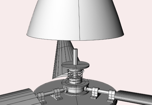

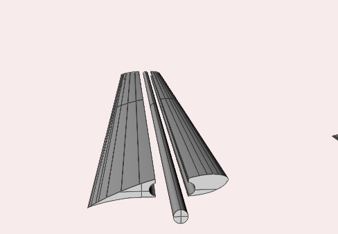

Two general designs that I came up with (the concepts are by no means original.)

Ooops.  Forgot text.
First one was actually a design for a centripetally powered system to move the parts of the dynamo apart so that it would be easy to start, and then move them back together as the blade got up to speed.  This still might be an alternative to feathering a prop.
You could modify this to turn the shafts of the prop blades instead of moving the parts of the dynamo.
Second one is a recent plan for automatic centripetal feathering.  As the prop rotates faster, the blades are forced outward against springs that try to push them inward.  In the course of moving outward, the shafts are forced to turn by lugs that engage an circumferentially angular groove.  As the prop slows, the springs pull the blades back inward and they rotate back to a less feathered position.

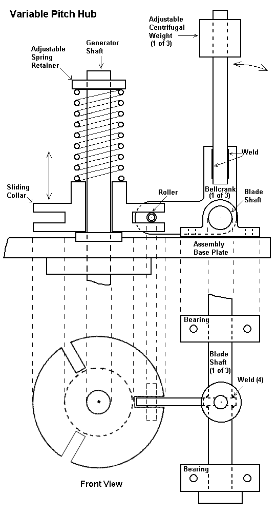

by Electric Ed on Thu Oct 28th, 2004 at 08:15:43 PM MST
Here is a basic sketch of a hub we built years ago. It worked quite well, except for some "hunting", which I was convinced could have been corrected with the proper combination of weights and spring tension.
Unfortunately, it was wrecked before the adjustments could be made, due to the "temporary" tower collapsing. You are no doubt aware of the "got to test it now" syndrome. :-)
The sliding collar keeps the three blades pitch syncronized.

Re: blade to hub connection for variable pitch (3.00 / 0) (#11)
by jacquesm (j@ww.com- I run a whitelist, add 'stjoes' to msg) on Fri Nov 5th, 2004 at 01:56:35 PM MST
(User Info) http://www.greenbits.com/
do yo have some more details about that governor, perhaps a much larger image ?
It sure looks more organized than mine :)
