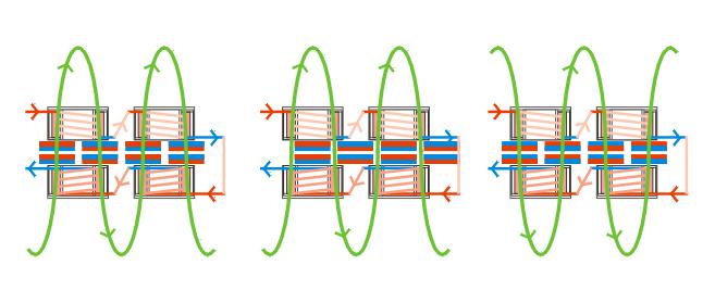

this is what you woulda seen from your one mag one coil experament
perhaps later i will draw multipal mag pics for ya showing y you have to have a nsnsns arangment to the mags when using the coil mag spacing used in single phase radial alts

Re: 1 magnet 1 coil (3.00 / 0) (#14)
by finnsawyer on Wed Oct 6th, 2004 at 10:19:17 AM MST
Troy should have shown two of the waveforms on his scope.  You would have seen a dead zone between waveforms.  With the magnets NNNN.. you need a spacing between them so that both sides of the coil aren't over a magnet at the same time.  If they are the voltages induced in them will cancel.  If the spacing is right you can get a sine wave out.  In order to make this work, however, you need another row of magnets on the other side of the coils arranged SSSS..  It's just another way of doing it.

Re: 1 magnet 1 coil (3.00 / 0) (#7)
by daleh007 on Tue Oct 5th, 2004 at 12:19:23 PM MST
So, I assume that the two coils you show are in series and this would effectivly double the size/voltage of a single magnet/coil waveform?

Re: 1 magnet 1 coil (3.00 / 0) (#13)
by troy on Tue Oct 5th, 2004 at 03:33:50 PM MST
Yes Dale,
the voltages in this arrangement would be additive.

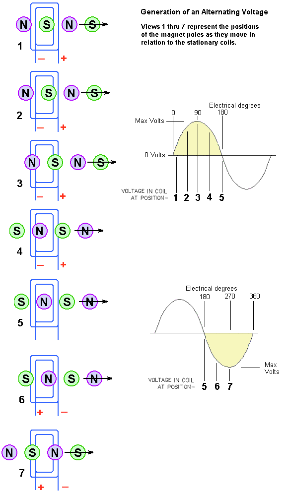

by Electric Ed on Sat Oct 9th, 2004 at 10:58:46 AM MST
Typical single phase AC sine wave generation is illustrated below.
If the magnets shown as South poles were removed from the arrangement shown, south poles would form in that location anyway, as a consequence of North poles existing in their present locations.
The waveform would still be the same, but the voltage would be lower with the weaker field.
